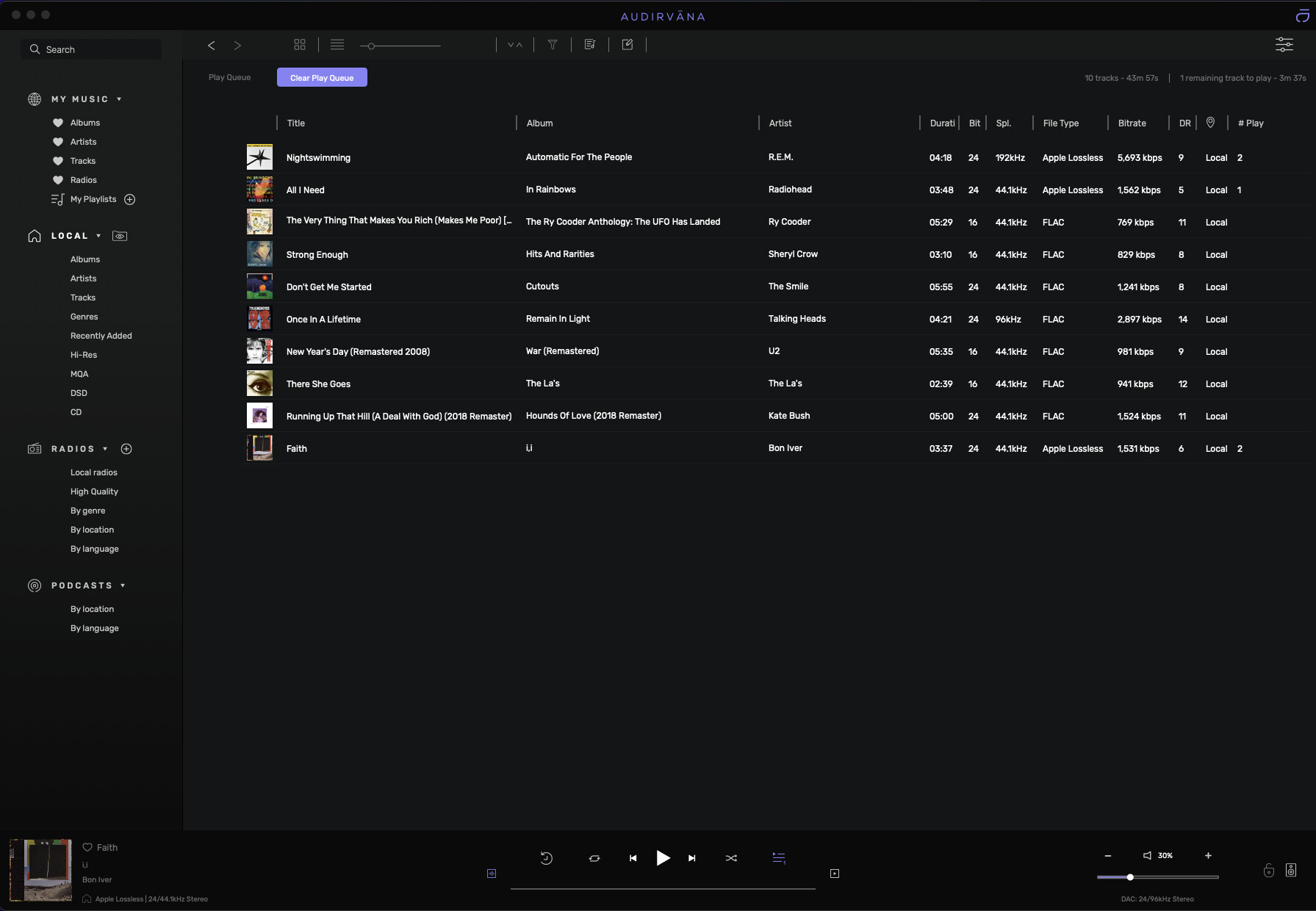

Here is an example of the issue, albeit a less severe one. Below is a screenshot of the play queue played this morning to the Phantom II’s. All 10 songs played perfectly and sounded great.

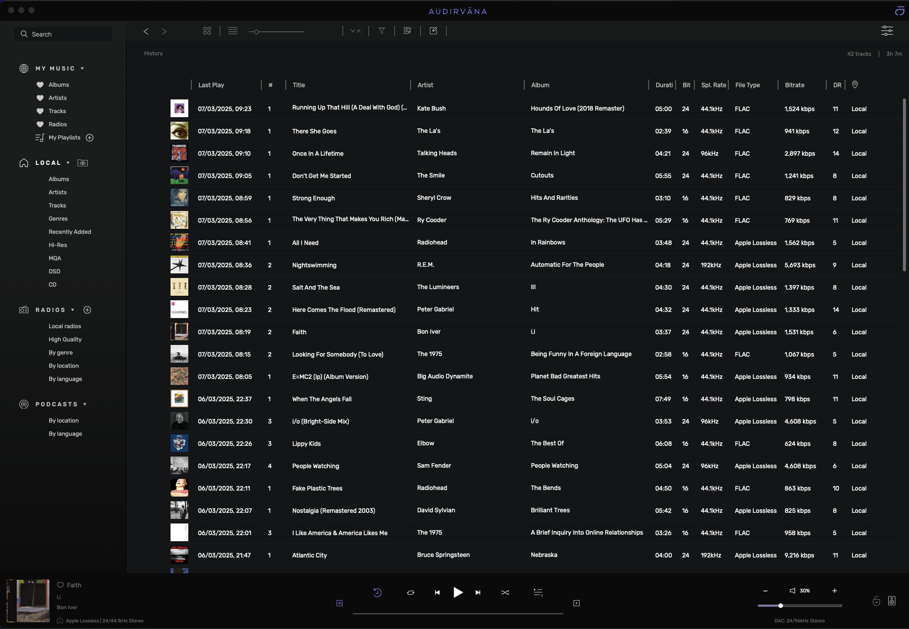

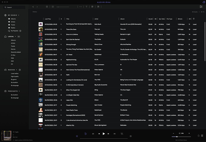

And here is the resulting Play History view. You will note that both “New Years Day - U2” was not recorded as played but it actually played perfectly. You will also notice the final track in the play queue “Faith - Bon Iver” was also not recorded as being played.
