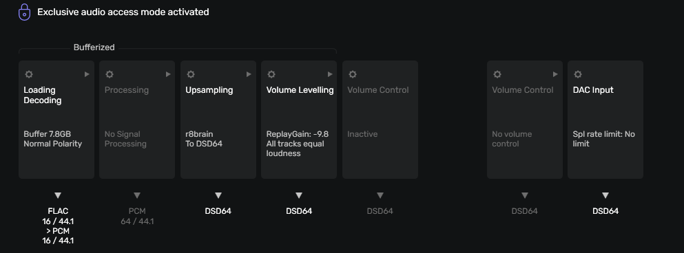

Hi, I’m new with Audrivana. I’m wondering why the Leveling is done after Upsampling but not before it wen I choose Upsampling to DSD. It’s well known, then it is not possible to change the volume in DSD format.
So probably it is needed to re-convert to PCM, change the volume and then convert to DSD again. Wouldn’t it be better to do the Leveling first on the PCM signal and the convert it to DSD?

But the screenshot of Audrivana
shows the opposite. The step Volume Levelling follows the step Upsampling, which is confusing . So what’s the truth?
Upsampling is done in PCM. The conversion to DSD is done by something called ā€œdelta-sigma modulationā€ or ā€œsigma-delta modulationā€ (two names for the same thing). The DSD specification calls for -6dB reduction after upsampling and before conversion to DSD, but in practice -3dB or so is probably adequate. Audirvana gives you a choice of what level of reduction you would like to apply.
Since this volume reduction is applied in the middle of the upsampling and modulation process that we informally call ā€œupsampling to DSD,ā€ how should it be visually represented without being overly complicated? What you see is the visual representation Audirvana has chosen.
To avoid being confusing, the two steps, in my opinion, should be shown in opposite order:
first: Volume Levelling with PCM input and still PCM output
following by : Upsampling, in this case conversion PCM to DSD by delta-sigma modulation with DSD output
If it was already so, what in my opinion makes more sense an probably is closer to the truth, I wouldn’t ask this question.
Volume Levelling with input DSD (output of the previous step) and output DSD, like on the screenshot above, is misleading and leads to the conclusion that there is another DSD to PCM and PCM to DSD conversion inside this step needed. I think/hope such change in the order of the displaying these 2 steps would be very helpful and technically understandable.
