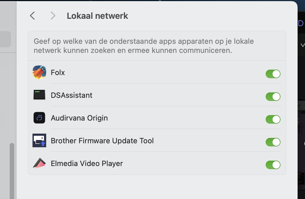

When I start Audirvana Origin, I have to open the Local Network settings first from within the Mac OS system settings, to put Audirvana off and on again, and then restart Audirvana. I guess this is an MaC OS problem? Who knows and is there a cure?
Have you tried to turn it off in your picture…
then close Origin.
Restart your Mac
without opening origin at startup
remove it if it is in your login items for one time.
Go back to that local network window and allow Origin back,
Open Origin, play a song, it should not ask again.
I still have exactly the same issue albeit it is less frequent now with 15.4.1 than earlier versions of Sequoia. It is 100% a Sequoia issue. After first starting up if access is denied I go to Local network, then toggle off and on any one of the application entries, it does not need to be the Audirvana entry…. then go to Audirvana and just click the network refresh button and all endpoints re-appear. All will then be good until I shut down the Mac. On a restart the issue will then sometimes re-occur. not always but about every one in three restarts.
It seems to be when the Mac first starts something in the network handshake when the Mac connects to wireless that sometimes prevents local network access being turned on. I wonder whether in my case it is possibly caused by using WiFi 7. Macs do not yet support WiFi 7 so maybe they are not overly focussed on compatibility yet…… who knows.
Some people using Roon are also still reporting issues so not Audirvana specific.
Worth giving @RunHomeSlow suggestions a go but in my case has not resolved the issue.

Just for information 15.4.1 seemed to resolve this issue for me. Not had a repeat. Currently running the release candidate of 15.5.0 with also no issues.
Started seeing the local network access issue again on Tahoe 26.2 and finally worked out what was causing it. For the first time in ages ran an Ethernet cable to my desk from the router in my home office after which the local network access permissions issue re-occured. Seems to be a macOS issue when my MBP boots with Ethernet network connection, no doubt a timeout issue on the handshake. Never occurs when I connect via wireless only. Seeing as the MacBook Pro’s have WiFi 6E and the Ethernet network interface is limited to 2.5 gbps probably no difference in performance other than reduced latency with Ethernet.
