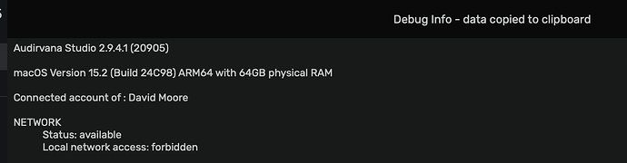

For those like me who are getting a little tired of having to toggle off and on Audirvana access to local network devices in order to stream to local network endpoints and had hoped for a fix from Apple in 15.2… I have installed the RC of 15.2 (build 24C98) and the screenshot says it all…

When you look at the beginning of your debug info…
do you see Local Network allowed?
Mine says the opposite, but in the Mac preferences of security and in local network, it is blue (on).
i close it in the Mac prefs… quit Audirvana. restart Mac, open Audrvana, see the Audirvana question and went back to pref of Mac and allow the the local prefs… Now my debug show Allowed.
debug
network
No access is reported as disabled in the debug info, hence the dialog pop up. Can confirm when I get this after a reboot there is no access to my network endpoints, hitting the network refresh button in AS results in nothing. Doing the toggle (which is on) off and back on and then clicking the network refresh button in the AS device selection brings back my UPnP devices (TV,s, KEF and Chord streaming devices and my daughters B&W Zeppelin)
One interesting thing is that a chromecast option to KEF speakers has always shown in local network options , since the release candidate of 15.0, however as access is denied when trying to select it results in a crash of AS.
Must admit am intrigued as to why you do not see this. So I just erased my mac and installed 15.2 clean install, then installed Audirvana. So the only software on my Mac is 15.2 and Audirvana Studio 2.9.4.1. As such the only startup items are from Audirvana, nothing else.
After a reboot I still get the popup and access is forbidden (see screenshot). Question… does your mac connect to the network via ethernet or wireless?

Yes it is turned on, when first opening AS macOS puts up a dialog asking for permission to allow AS to access local network devices. When I go to the local network pane the AS toggle is always on. I have to toggle it off and back on before I can access my endpoints on the network.

The most interesting thing I have found is when I go to local network I do not have to toggle off and on the entry for Audirvana to regain access to UPnP devices I can toggle any of the application entries ( Capture One or CyberDuck) and then AS regains access to my endpoints after hitting the refresh button in AS. This suggests to me the system to facilitate access has frozen in macOS and toggling off and back on any of the apps forces a restart. But then I am not an IT guy so this kind of stuff is way over my head!
To answer your questions on the firewall the test this morning with only macOS and AS installed on my Mac there was no firewall active (the macOS firewall was disabled) so my system was totally open. Same after a reboot local network access was forbidden.
