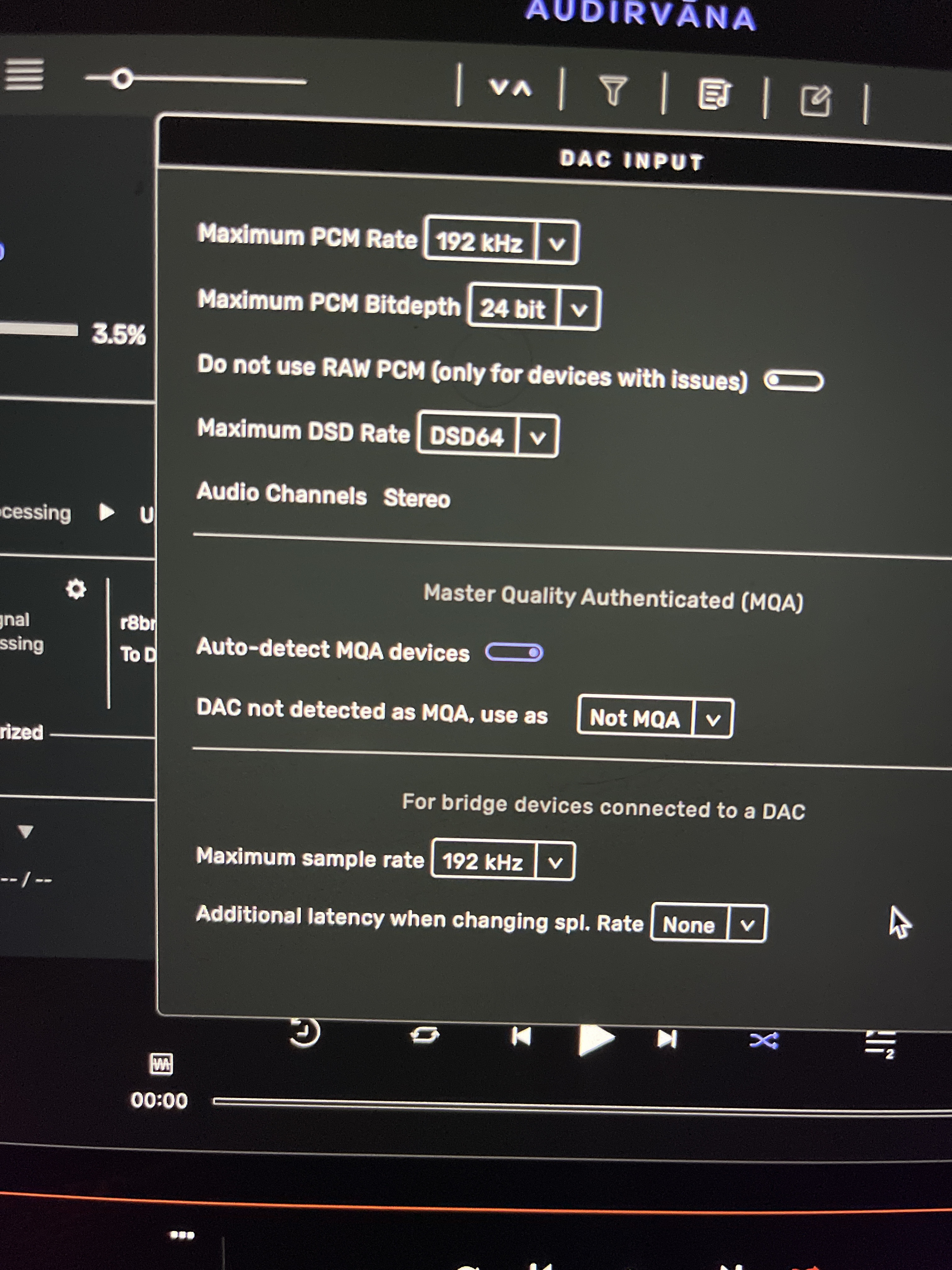

*I can adjust to 384 on audirvana
I put it to 192 because benchmark Dac 3 max in is 192 stock …
I’ll change my settings now

So I can’t use the settings you have anymore ?
How about for Bridge devices to Dac.? Should I Just put no limit or leave it to 192 as well ?
If you managed to change the settings:
You may upsample PCM and send 384 KHz to your iFi Zen Streamer, but it will downsample the stream back to 24-192, because this is the restriction of your DAC. So upsampling makes no sense.
You may also upsample to DSD and send DSD 256 to your iFi Zen Streamer, but it will downsample the stream to DSD 64, because this is the restriction of your DAC. In this case, the upsampling won’t make sense, because it’s a downgrade of the 24-192 source.

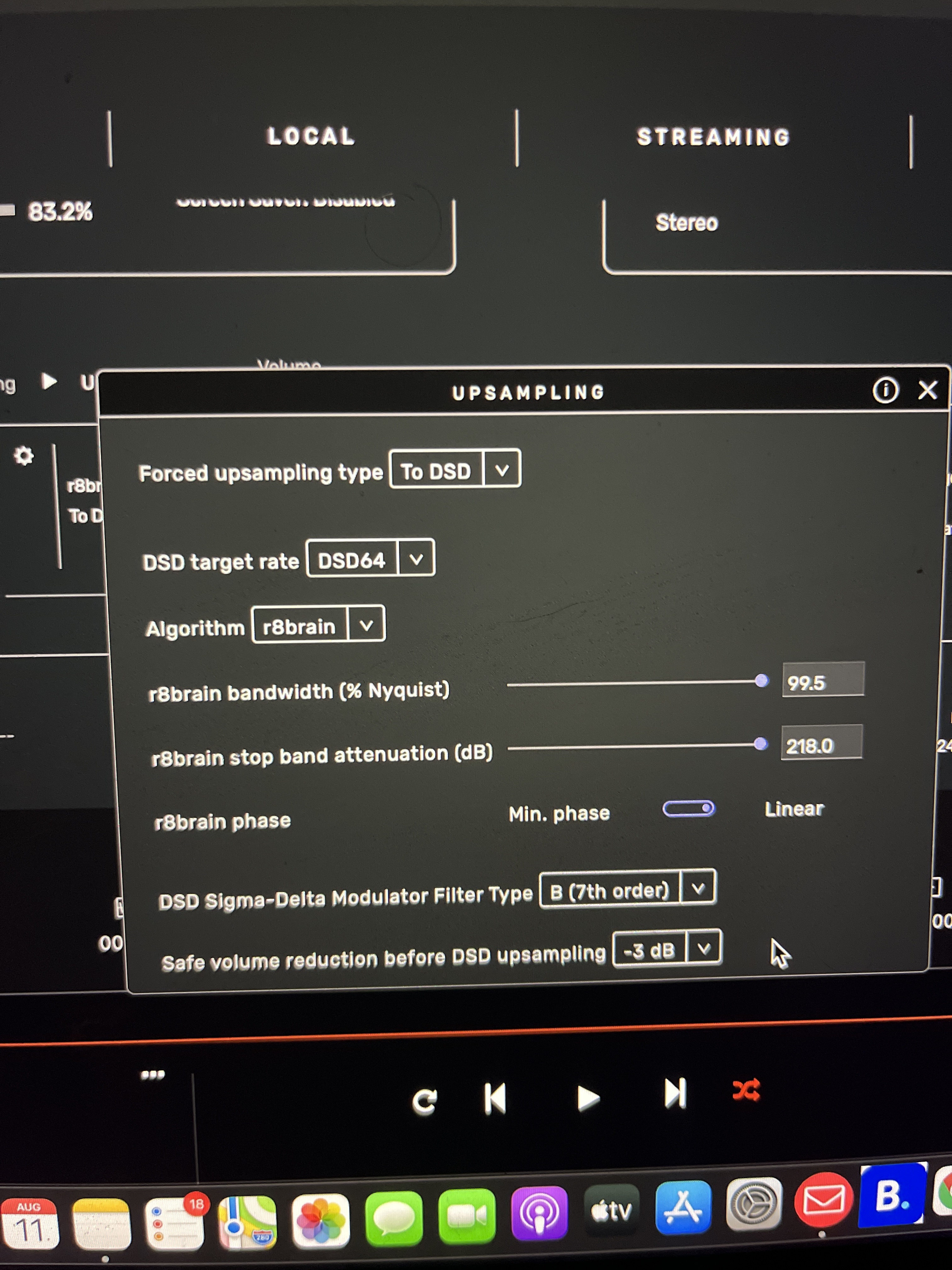

Yes got lots of 16 bit files too … ok let me show you guys
It’s fine. With this setting, you can upsample your 16-44.1 tracks to DSD 64.
With your DAC, you have also the possibility to upsample your 16-44.1 tracks to 24-192.
Compare both upsamplings to see which one sounds better to your ears.
Upsampling can make it better. It is not a fact that resampling will give you better quality. It’s a matter of trying.

You can choose from the sox and the R8brain resamplers. DSD and PCM. PCM maximum or Powerof2. Bandwith, stop band att. phase. It all makes a different.
They will be downgraded if you upsample them to DSD 64.
You can upsample all your 16-44.1, 16-48, 24-44.1 and 24-48 to DSD 64 without downgrade.
You can upsample your 16-44.1, 16-48, 24-44.1, 24-48 and 24-96 to 24-192 without downgrade.
