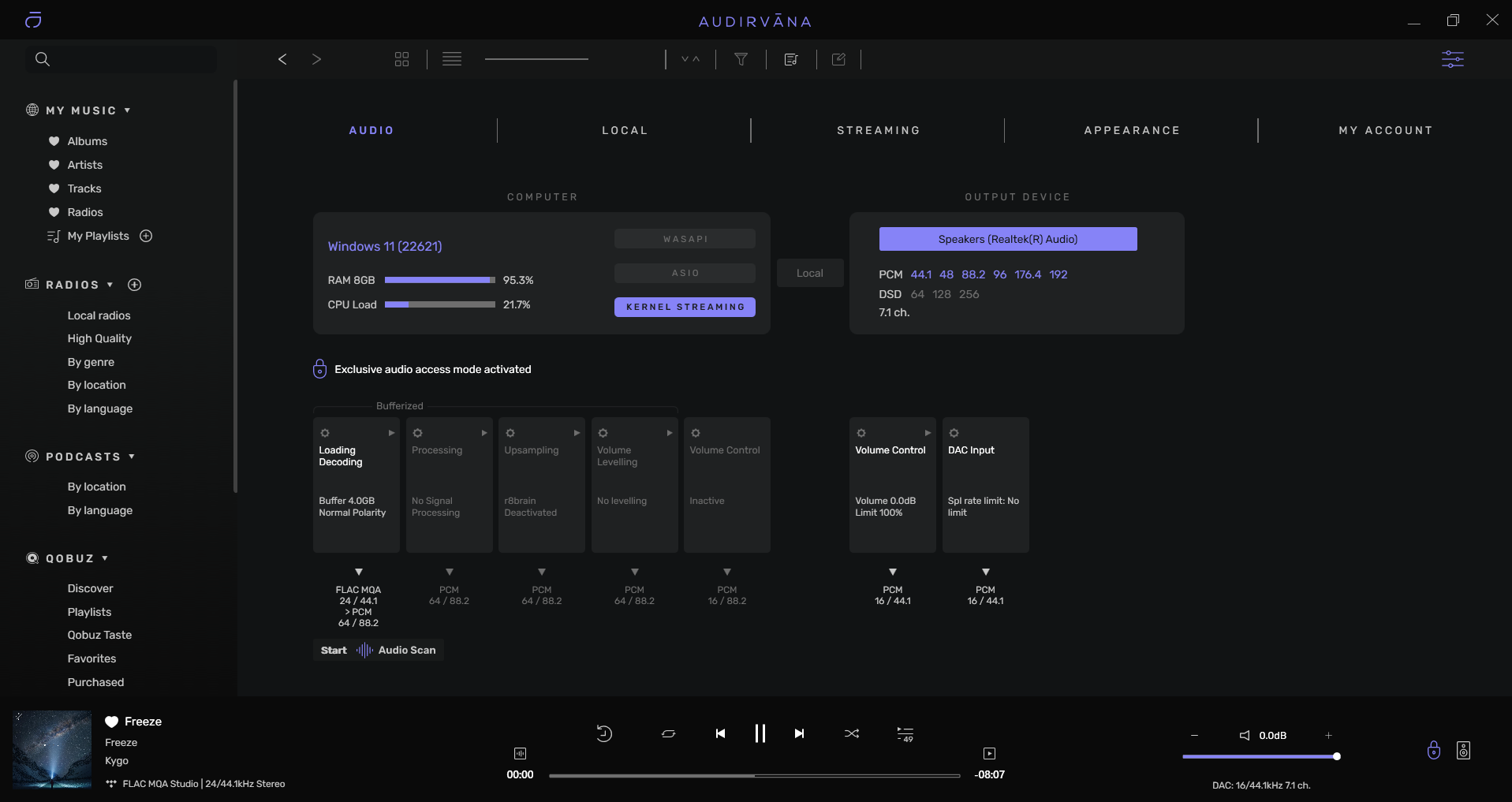

If you try to select Kernel Streaming instead of WASAPI, do you have the same behavior?
Yes here it doesn’t show error “Device not found” music gets load but the progress bar stays at 0 and hence no sound comes.

After I reinstalled Audirvana now, Wasapi is working fine, sound is coming but in Kernel streaming the behaviour is same that I explained in above reply.
Just after installing the Audirvan when I selected Kernel streaming and clicked to play a song, it got crashed with a file Audirvana_Studio.dmp getting created.
When I am using Kernel Streaming with portable dac it is working fine, sound is coming. But issue is still there with speakers.

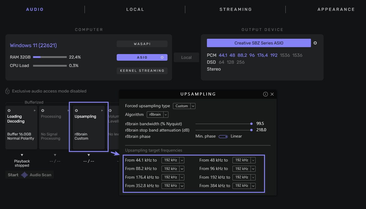

After reinstall Audirvana, just try songs with 16 bit and 44.1khz
If they work, go higher with the sample rate until you get the error.
I set my upsdamling to 192khz for all sample rates and have had no problems since then.
