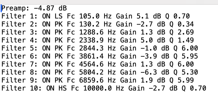

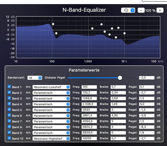

Copying the Data from the AutoEQ-File to N-Band EQ I have a question:
GAIN = PEGEL, that is clear. But is Q = BREITE (Width)?
And is Filter LS the same as Lowshelf, and HS = Highshelf?

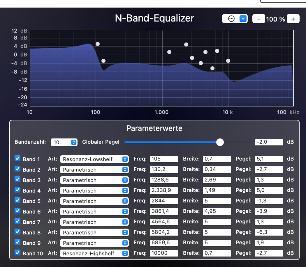

![N-Band|665x500]
With these settings it seems to work well and not be worse than with Roon Muse :blush:
Yes to your assumptions about Q and LS & HS… Looks like you have it figured out… Good job!!! Now sit back and enjoy your audio nirvana…
