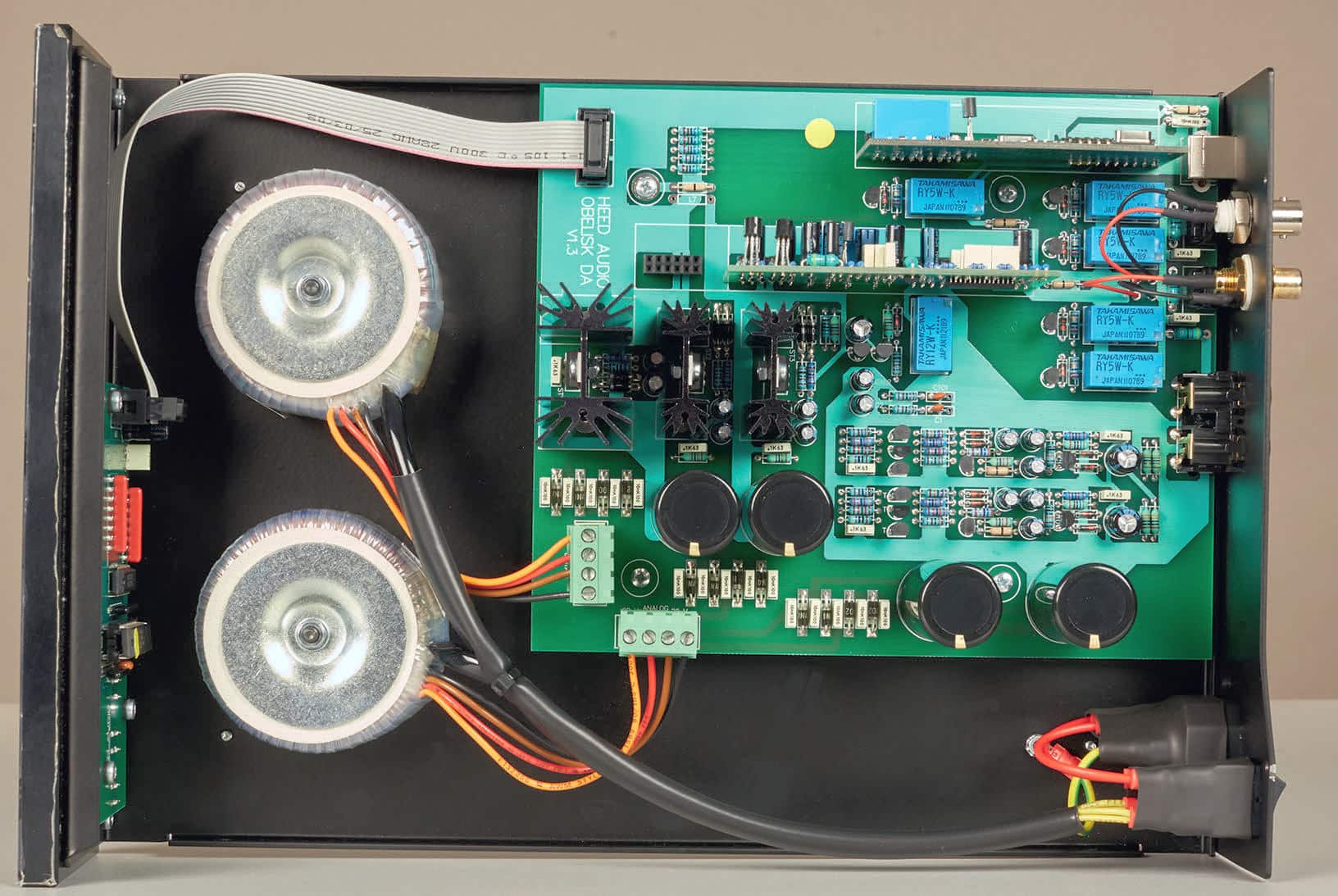

I have a Heed Obelisk DA dac, it has its own built in power supply, dedicated toroid for both the analogue and the digital side, the switch and the LPS serve the Ian Canada streamer.
