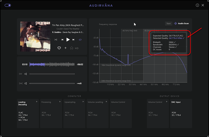

How to see playback bitrate in Roon client:
In Audirvāna you have the option to scan the track so that the app will verify (detected quality) if the Bitrate & resolution of the track is what the metadata in the file says (expected quality).
Selected track from playlist:
Show Settings > Audio Scan
Click Start:
and as you can see this file is a correct 24bit/176.4kHz file:
but you will notice in the bottom right that my DAC (Hugo2) is playing it as 32bit/176.4kHz
That will prove in Audirvāna exactly the expected and output bitrates. if you have a Windows OS you can add the bitrate column to your folders as a check of the files bitrate properties:
Cheers
V/-
