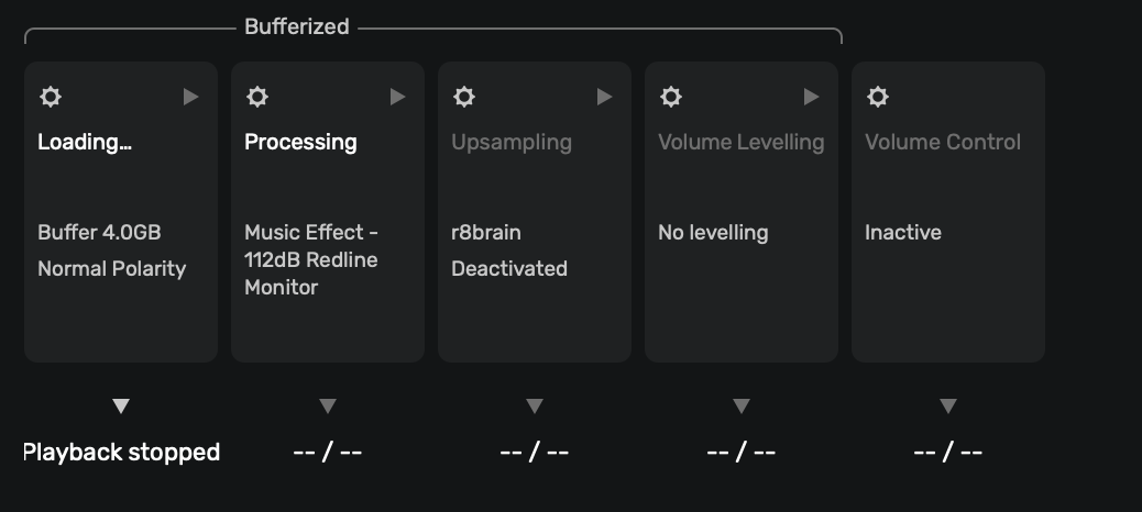

The order of processing is as expected (see screenshot)
I use it this way for all PCM playback:
Playback buffer → HRTF (AU plugin) → r8Brain (modulating all PCM to 5.6MHz DSD128 via DoP1.1) → Output to DAC
Mine is like that picture also…
@Ralf_Napierski you have a picture to show us
or you can see something that we don’t ??
or that graph preferences is just a show?

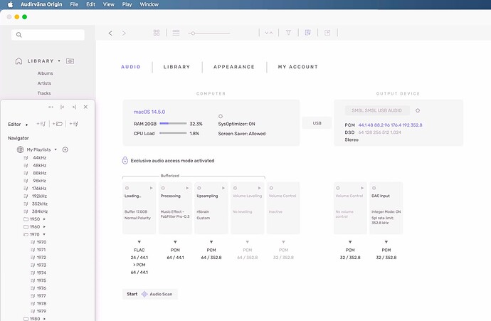

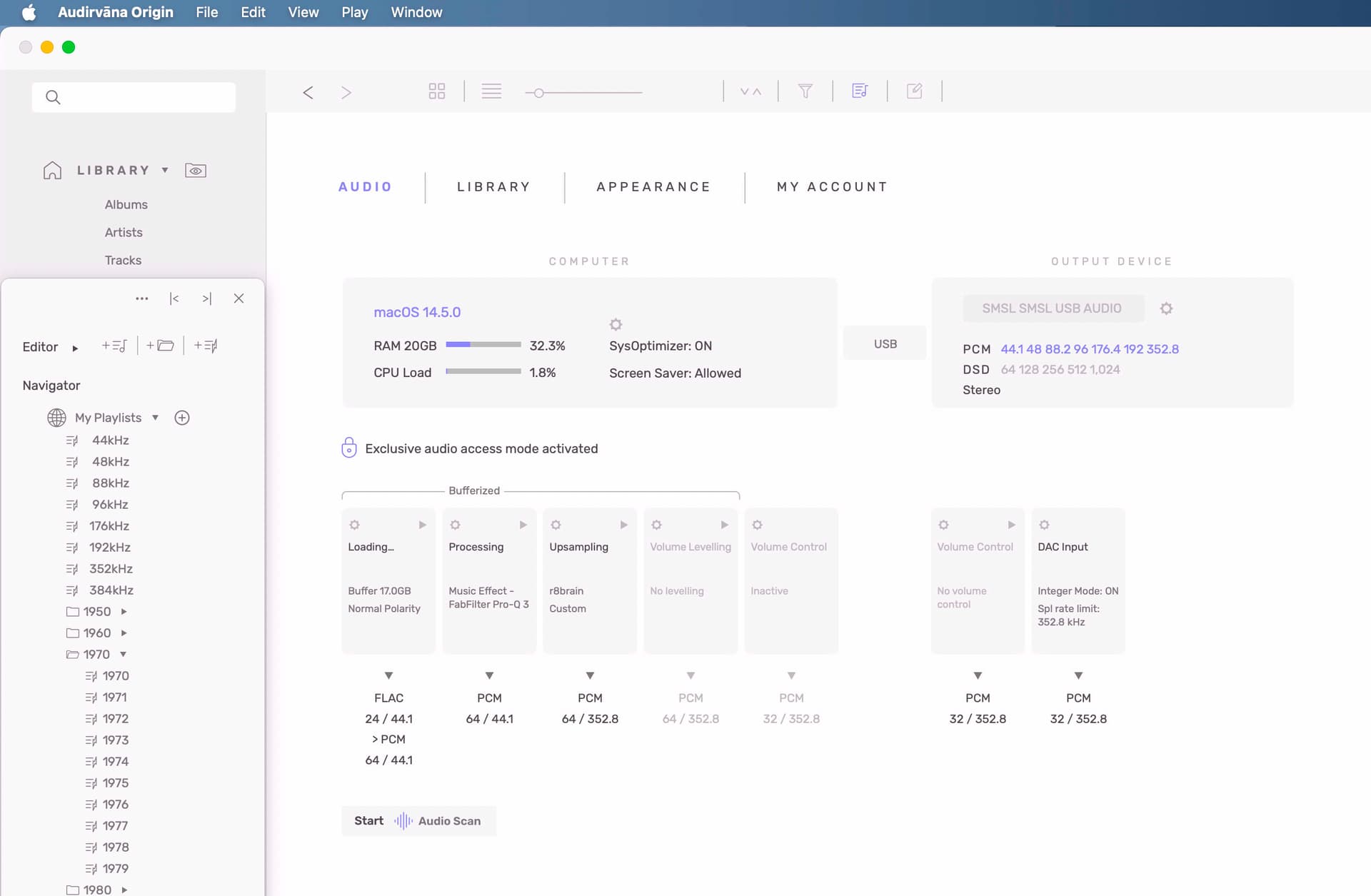

Thank you, but the order on the sreen is the same. The order in audirvana is wrong.
I am using Dirac plugin. It allows max 192 kHz input. If i upsample in audirvana to 768 (for my Chord Qtest) the Dirac plugin does not work. If I upsample to 192, it works. So the chain is upsampling → plugin → output

This is my experience… The signal is buffered, presented to the Plug-in architecture and then sent to the sample-rate converter. for output… I know this because when I feed a PCM 352.8kHz file into the Plug-in architecture using an AU plug-in that is certified to 96kHz PCM… some of the parametric functions of the 96kHz plug-in are not available due to sample-rate variance. After passing through the plug-in, the 352.8kHz PCM file is then modulated to DSD128 (5.6MHz) and delivered to my DAC as DSD128…
Fact: The plug-in architecture is unavailable when playing DSD files…
(Note: my screen-shot above was taken without my DAC connected, and using the macOS default output device(s) so r8Brain was deactivated in this playback scenario)
