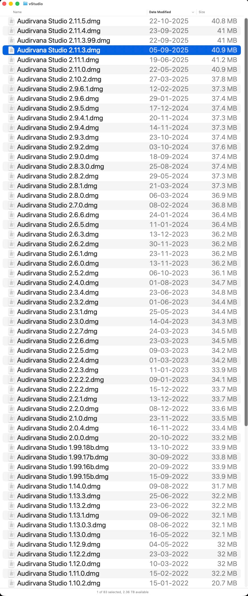

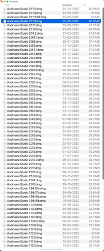

So all was normal two updates ago?
It seems you don’t download each updates and keep them, just in case!!
Which one you want me to upload in my dropbox??
By the way, i don’t even use Studio… Origin user. You want Origin? :slight_smile:
If you want by accident 2.11.3, it is already in my dropbox…
