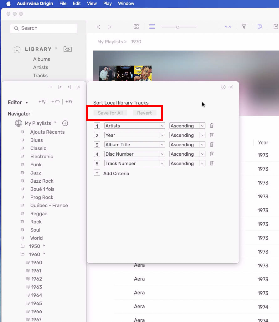

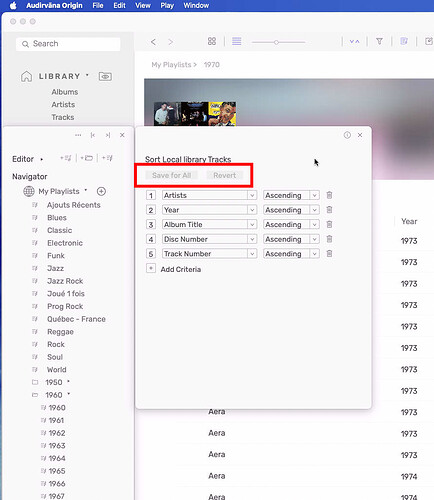

Is there any way to have the “Column Names” be specific to a Playlist?
Example:
I would like to display “Date Last Played” in my “Last Played” Playlist, but I don’t necessarily want that column in other Playlists.
didn’t succeeded trying it
there is many settings to play with and i don’t want to mess too much as i know Audirvana :slight_smile:
I only use smart playlists and they are all done and running…
You see this prefs… mine is already save for all, so i don’t know,
revert doesn’t seem to work there…
