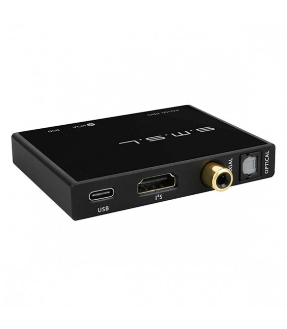

If you want to connect your Mini to the I2S port of your DAC, you need a device like this:
You will connect the Mini to the DDC with a USB cable, and the DDC to the I2S port of the DAC with a HDMI cable.
Merci @Cloclo c’est ça que je voulais savoir… si un truc exist pas trop cher pour que je test l’upsampling a 352/384 en PCM sur mon DAC qui ne saute pas en USB :grinning:
Vais regarder ce truc plus près tantôt :grinning:

i think i will buy the @Cloclo link as i can found it on Amazon for 80$ CAN shipped in 2 days :wink:
Oups, i clicked on Amazon :slight_smile:
92$ CAN tx included and shipped tomorrow… :slight_smile:

I also bought this interface.
I’ll leave it here if I need another output on the computer other than USB.
