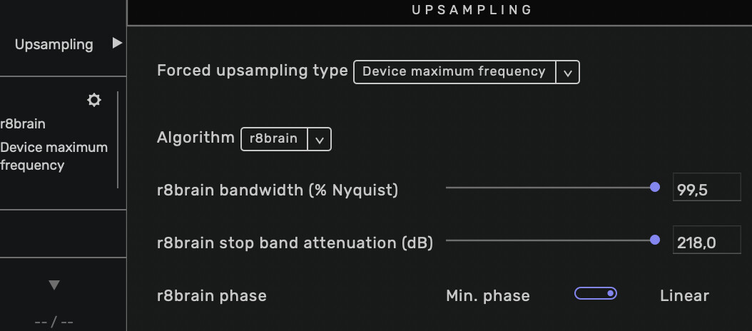

Can you try to activate upsampling and select “Device maximum frequency”?
Yes, of course, now I will try to do it.
Thanks!
Unfortunately it didn’t help. Stuttering appears.
