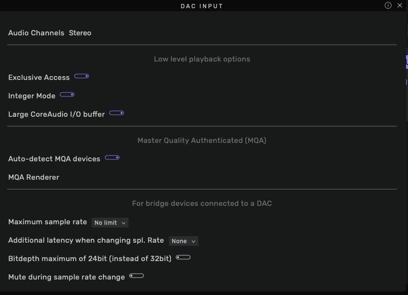

No DoP setting…
Is this Studio or Origin?
If you are using an iFi DAC, this DoP option will not appear.
