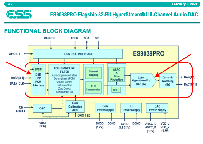

The ESS Sabre chipset(s) used by the Okto DAC are PCM-centric… These DACs decimate 1-bit PDM (DSD) signals to PCM… So your best sound-quality will be reproduced by having Audirvāna do the decimation (down-conversion) of the DSD file to a PCM file… It is better to have the computer do the decimation processing, so to off-load this from the ESS chipset DSP/SDM processing where the conversion processing produces noise (jitter) in the chipset clocking topologies…

By decimating (down-converting) all DSD files to PCM in Audirvāna you are removing the burden of de-embedding the 1-bit PDM (DSD) signal from the DoP carrier file and removing the burden of the decimation (down-conversion) of the 1-bit DSD file to PCM, from the ESS chipset DSP architecture, where this DSP processing induces noise (jitter) in the chipset clocking topology.

In the case of ESS Sabre DACs, you are creating processing overhead in the chipset DSP when you present the DAC with a DoP signal, because the DAC is PCM-centric and converts all signals internally to high sample-rate PCM for output as multi-bit PCM…

As you see, the ASR measurements are PCM-centric… The ESS technology is what it is…
“…The DAC8 PRO/Stereo also process native DSD as DSD from the beginning to the end…”
I am sure this statement is true, however, what does this mean…? What is meant by …“the end”? Is the signal being delivered for output as 1-bit PDM or multi-bit DSD-Wide? If the ESS DAC is involved it is multi-bit DSD-Wide…
I know it is hard to accept if you were expecting a DSD-centric DAC with an unfettered 1-bit PDM signal-path to a simple low-pass filtered D/A output…
