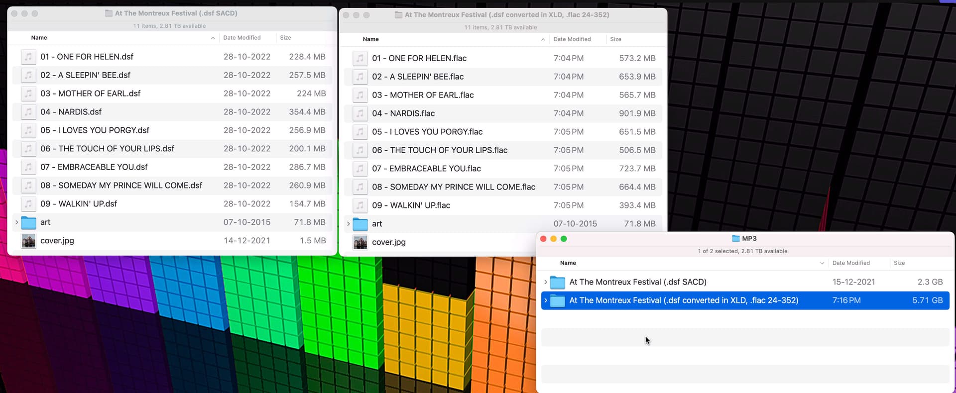

i just drop an Bill Evans SACD (.dsf tracks) to XLD on Mac,
to convert the .dsf in FLAC.
Easily done, by default, it made 24/352 flac files… for free.
Weight more than double now, but seems to play like the .dsf
Have you tested XLD ?

XLD is excellent. I use as much freeware as possible……
