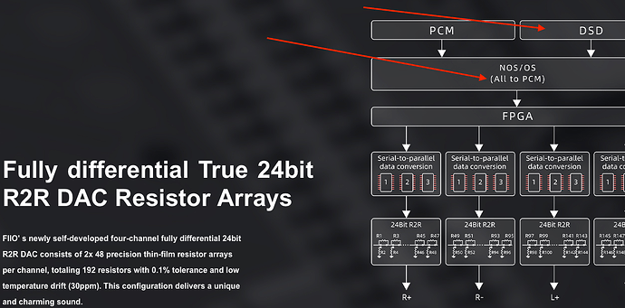

Because of the nature of the K11 R2R DAC architecture, you are not losing anything by converting DSD to PCM in Audirvāna… You may gain some improvement in sound-quality by offloading the DSP decimation of the DSD signal to PCM in the DAC platform… The K11 R2R does not provide a pure unfettered 1-bit PDM (DSD) output signal… it is converting to multi-bit…

It really doesn’t matter in the context of the K11 R2R DAC, unless you can show that the DAC does not decimate the DSD file and supports an unfettered 1-bit DSD signal-path to output.

This is from the K11 R2R DAC overview and confirms that DSD files are converted to PCM… :wink:
Also confirmed in the debug report of the ‘15 virtual formats’

On macOS, convert all DSD to PCM in Audirvāna… the K11 R2R converts all DSD files to PCM by nature of the DAC architecture.. The same for DSD transmitted via Windows… All DSD signals are converted to PCM for output in the K11 R2R DAC.
If you are connecting the Mac via USB to the DAC, to transmit DSD signals via DoP, the maximum DSD file sample-rate you can play is DSD128, because the DAC supports PCM 24/352.8kHz which is the DoP (DSD over PCM) PCM carrier file sample-rate for 1-bit 5.6MHz PDM (DSD128)… macOS transmits DSD via DoP on the USB bus interface.
