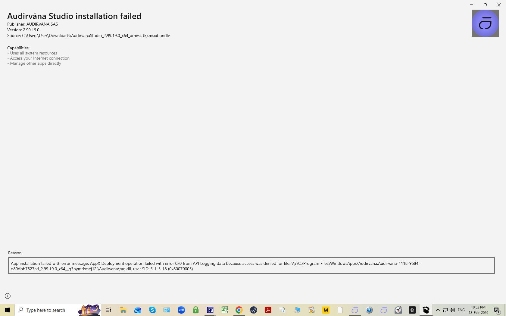

Just tried to update to the 2.99.19.0 version (from 2.99.18.0)…my antivirus quarantined it, but I got it out of quarantine. And it disappeared! Now it won’t open from anywhere (my PC or the website). Right now, I have reinstalled 2.99.18.0 (did not uninstall 2.99.19.0).I am getting a strange message from my anti-virus app about this new update. Note: I have added audirvana.com to my list of exceptions in the anti-virus:

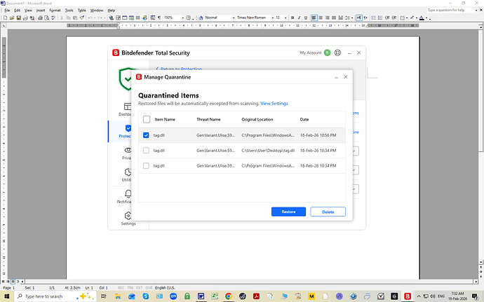

Can you please restore the file so it won’t be quarantined again for other users from Bitdefender and anti-virus related to it.
Bitdefender considers it a .dll file…and I am not sure how to proceed…
If you select all of them and click restore, is that enough?

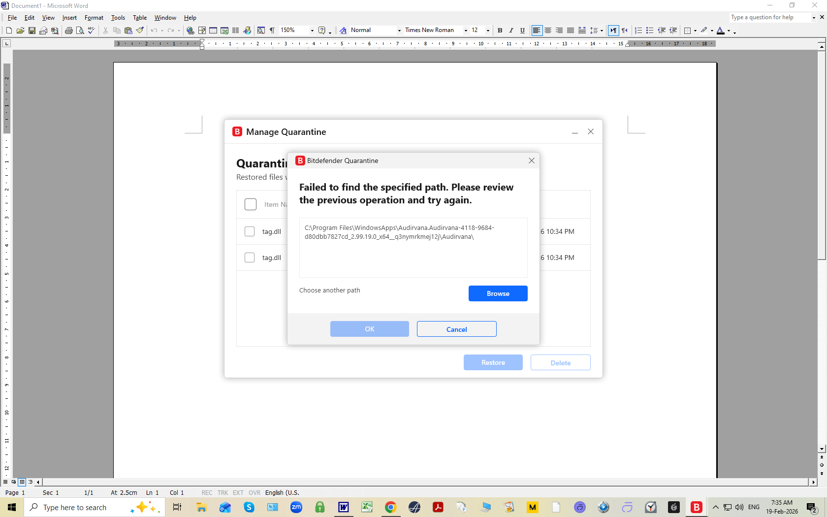

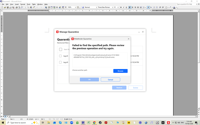

No, I get the ‘Failed to find the specified path message.’

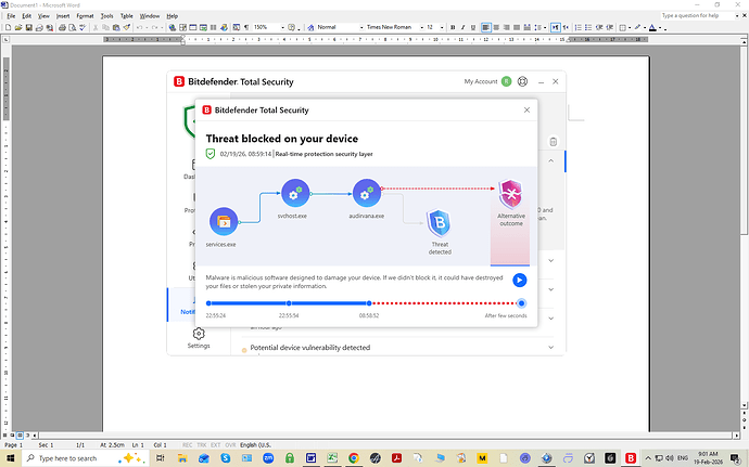

Plus…this message:
UPDATE: I was able to get access to the file specified by Bitdefender (by changing permission status in Windows) and AS 2.99.18.0 loads but 2.99.19.0 is still regarded as a threat by Bitdefender and is quarantined as soon as I try to update from .18 to .19. I can only load .19 AFTER it is declared infected by accessing the quarantine files. So, yes, I have .19 up and running, but I have no idea why Bitdefender should have an issue with this update when no updates or installations from Audirvana have ever been suspect. I wonder if others may run into this problem
