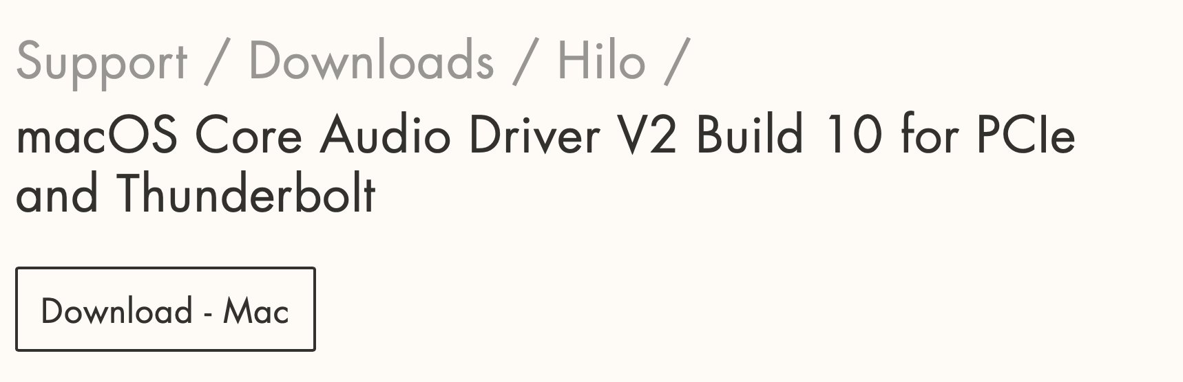

An obvious one and apologies if you have already done so but I assume you installed the macOS Core Audio driver V2 on the Mac Studio which was released on 15th January 2024? States that it fixes some issues with Ventura and Sonoma?

Yes, I installed the Lynx update almost a week ago. Made no difference.
