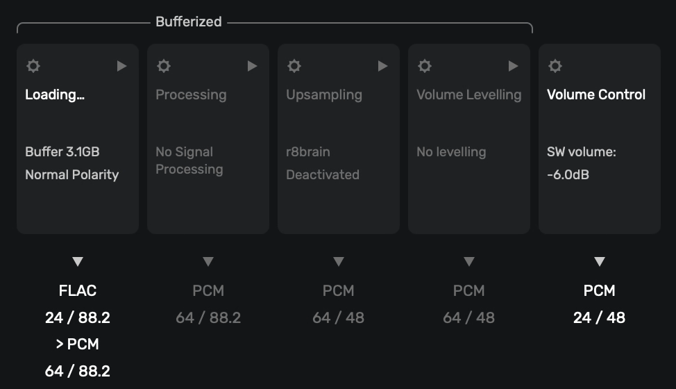

It appears that a sample rate conversion occurs in the processing chain before the volume control stage is reached, even when no sample rate conversion is configured:
Would it be possible to have a volume reduction stage before this conversion, so inter-sample overs during sample rate changes can be definitively avoided?

Thanks for the reply. I’m not using or converting DSD, in fact, the entire upsampling stage is deactivated. Yet, as evidenced by the screenshot above, a sample rate conversion from PCM 88.2 (or anything the source file happens to be) to PCM 48 is taking place. Now, this needs to take place somewhere, since the output device requires 48, but I would like it to happen after I had the chance to lower the digital volume. Like you said, gain management is essential prior to sample rate changes.
If you notice… The FLAC file is being converted to PCM with 64 bit math and the sample-rate is decimated to 48kHz (which is an illogical target for 88.2kHz… the target should be 44.1kHz to avoid round-off errors…) Sample-rate decimation does not add gain, the increase in bit-depth adds dynamic-range…. in the case of 64 bit math the theoretical dynamic-range is approximately 384dB! (where, in PCM digital-audio, 6dB = 1 bit) … The 64 bit/48kHz signal (The correct target should be 44.1kHz) is presented to the 64 bit Volume processes where the signal bit-depth is decimated to 24 bits (theoretical dynamic-range of 144dB) for output to the DAC.
The signal presented to the sample-rate converter decimation process is not altered by virtue of the 64 bit math, just the sample-rate…
However, (in the scenario you are showing) you are presenting the potential for truncation-distortion/round-off-error by setting an illogical target sample-rate of 48kHz for output instead of 44.1kHz.

My concern isn’t dynamic range. It is that the signal is subjected to sample rate conversion without the chance of reducing the level first. There is a risk of clipping inter-sample overs during this conversion, because sadly a lot of source material contains samples at or close to 0dBFS. I would like to reduce the signal level by at least 3dB before any sample rate (or D-A) conversion.

Yes, but replay gain (like SW volume adjustment) is applied after sample rate conversion, i.e. after any potential clipping of inter-sample overs had already occurred.

Yes. If you look at the screenshot in my original post, you can clearly see that the conversion from 88.2kHz to 48kHz occurs before both the volume levelling (replay gain) and SW volume adjustment stages. If that presentation in the Audirvana UI reflects what is actually happening.
Inter-sample overs are spurious, yes, but can occur en masse, in particular with ā€œloudness warā€ recordings. And no, I’m not suggesting that Audirvana is doing anything to cause them. But to be sure that they don’t lead to clipping one must reduce the level of the digital signal before any sample rate conversion (or D-A conversion) happens.

I understand that and I’m not worried about dynamic range. All I want to do is avoid inter-sample overs, which can only occur during sample rate conversion if the signal contains samples very close to 0dbFS. Dropping the overall level of the signal by a few dB will prevent them.

I’m not sure why you keep circling back to bit depth and dynamic range. Inter-sample overs have nothing to do with that. When you have two adjacent samples at 0dBFS then the waveform amplitude in between those samples (alternatively: on both sides of the samples) must be above 0dBFS. Similarly, the closer two adjacent samples are to 0dBFS, the higher the chance that this occurs. When resampling a signal like that, there is a high chance that sample values exceeding 0dBFS will be required, which of course isn’t possible, so the signal will be clipped.
That is certainly possible, but seems like a lot of effort. It would seem much much easier to reduce the level of the signal before any resampling occurs. Roon and JRiver can do it, I was just hoping something similar would be possible in Audirvana.

However, inter-sample overs do not only occur during D-A conversion, they can also bite when resampling a digital signal, namely when the resampler would be required to produce bit values in excess of 0dBFS. Since this isn’t possible, those samples will be replaced by 0dBFS, resulting in clipping. At least in integer PCM formats. With floating point formats, bit values in excess of 0dBFS can be represented, I believe.
I disagree. Inter-sample overs are a phenomenon that only manifests itself during resampling or D-A conversion. Having 0dBFS samples in a digital file is not ā€œillegalā€ in and of itself. By reducing the signal level prior to resampling or D-A conversion, inter-sample overs can be avoided.

No, the additional dynamic range doesn’t help, since the maximum bit values in 16bit, 32bit and 64bit integer formats are used to represent 0dBFS and map to each other. Only floating point formats can express values in excess of 0dBFS.
Now, if someone could confirm that the ā€œ64bitā€ format shown by Audirvana is actually a floating point format, rather than signed integer PCM, this would go a long way to allay my concerns.
They’re replacing them with ā€œ1ā€, where ā€œ1ā€ means maximum digital code (corresponding to 0dBFS). But replacing those sample values with 1, where they should have been larger than 1, is exactly the problem. Since the larger than one values cannot be expressed in any integer PCM format, these samples are clipped.
Yes, but unless the sample rate reduction is done by an integer factor, the new samples will sit at very different places along the time axis, so new inter-sample over situations can be introduced. But overall, a reduction in sample rate is much less likely to cause inter-sample over issues than oversampling.
The only way do guarantee that inter-sample overs do not cause clipping is level reduction prior to resampling (like JRiver does it) or level reduction prior to D-A conversion (like Benchmark does it).
