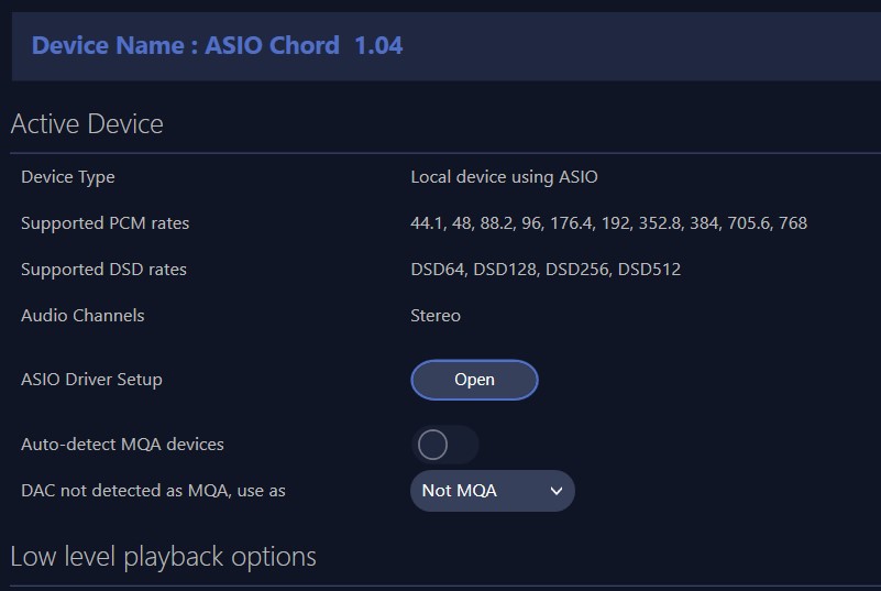

Hello,
When I play DSD files via ASIO, I only hear white noise whereas there are no issues playing DSD files via WASAPI.
The DAC I use is Chord 2Qute and the version of the driver is ASIO 1.04
I noticed that when ASIO is selected, “Native DSD steaming method” is not there.
However when Wasapi is selected, the “Native DSD steaming method” is there.
Also, when ASIO is selected, the supported PCM rates are up to 768 and supported DSD rates are up to DSD512 which are wrong.
I prefer to use ASIO as the sound is more balanced than when using WASAPI.
What would be the cause of this issue, the Chord ASIO driver or Audirvana? Any ideas?

I guess the issue is that Audirvana uses Native DSD option when I play DSD files. My DAC only supports DoP so that I hear white noise when playing DSD files.
Since there is no option to change DSD Streaming Method to DoP in the Audirvana settings, I cannot play DSD files.

Hi @Antoine . Thanks for your reply. I only have DSD64 files which I hear white noise. I believe it will happen with all the sample rates.
As you can see DSD Method is Raw DSD and it cannot be changed to DoP when using Chord ASIO driver.
Any ideas how this can be resolved?
