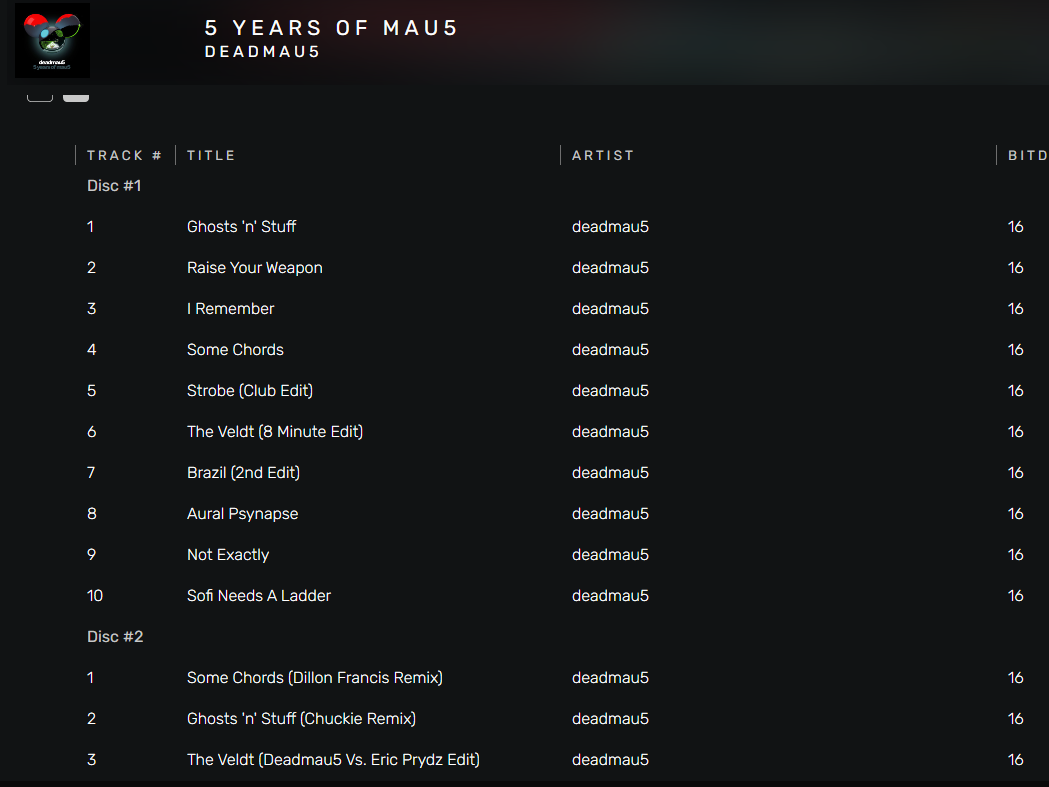

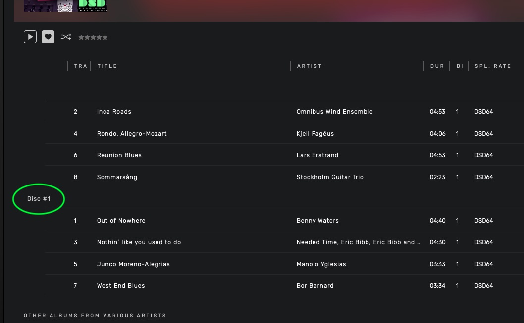

Why is Disc#1 randomly shows up on album song list
Recently randomly Disc#1 will show up among the song list for a album. Sometime Disc#1 and Disc#2 show up. When they show up, the song order will be messed up. Very irritating. It’s not consistent. Sometime they are not there.

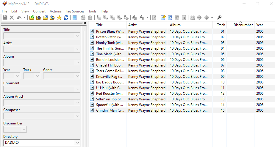

This is tagging according to Mp3tag:

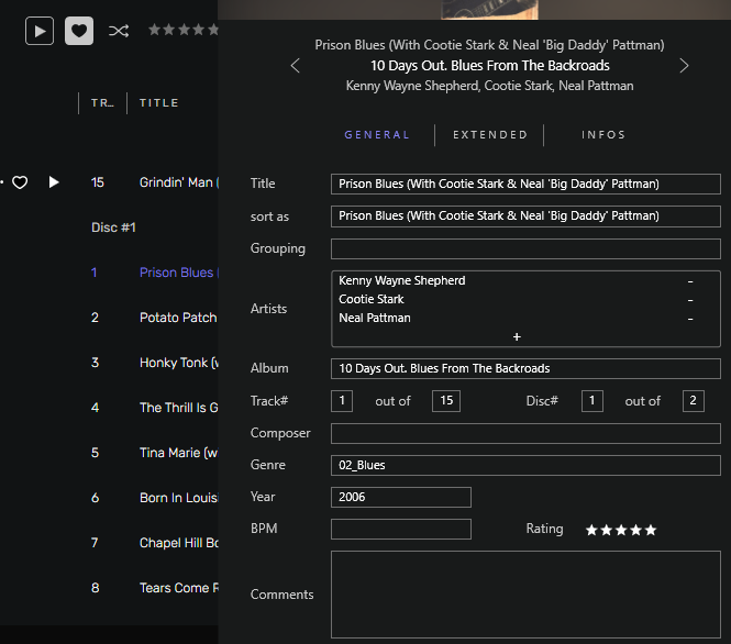

This is a tagging when cd is added an analyzed in Audirvana:
In Mp3tag there is no discnumber as you can see.
When added to Audirvana all tracks except track 15 is given discnumber 1 of 2.
Of course Mp3tag could be showing wrong information, but I doubt that.

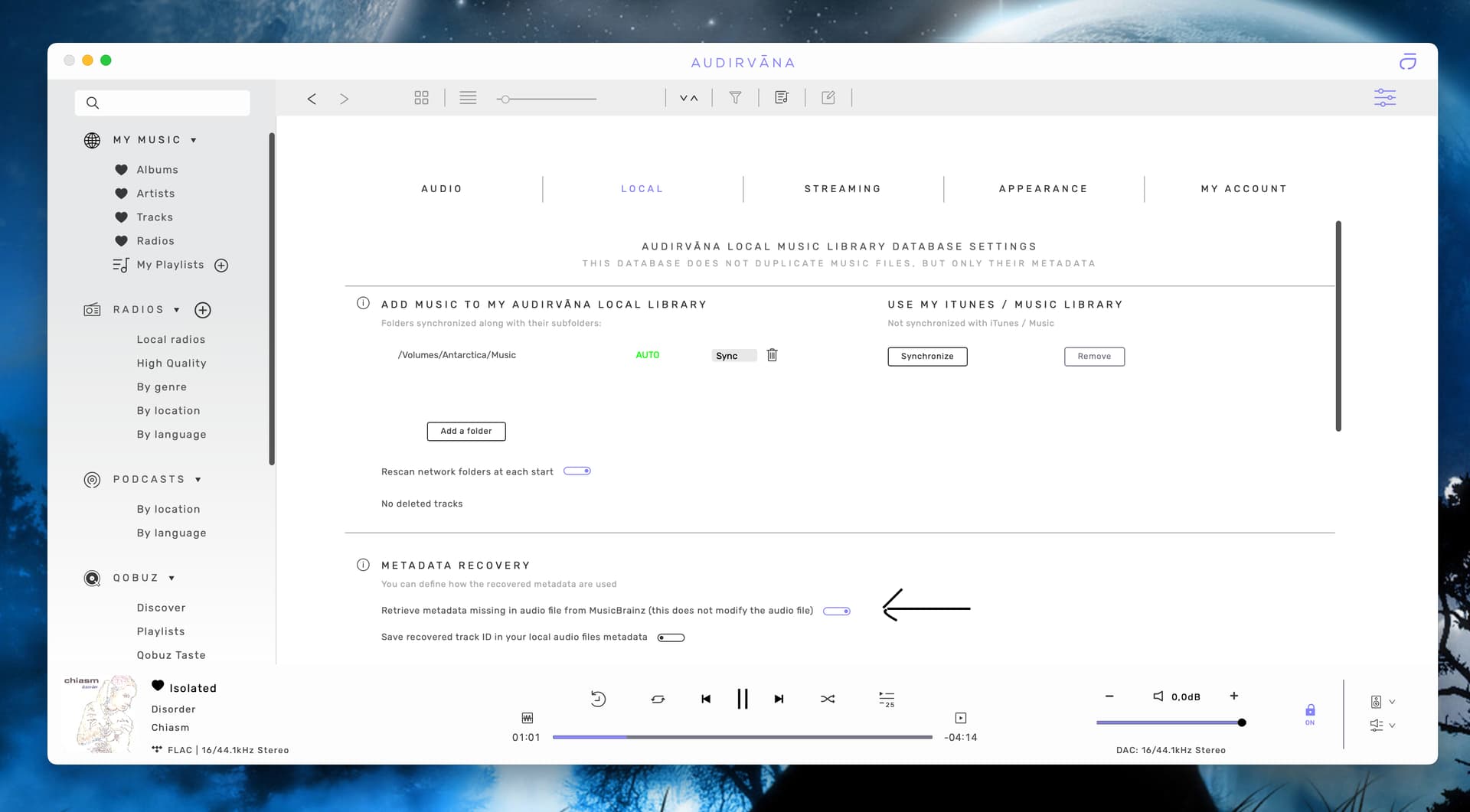

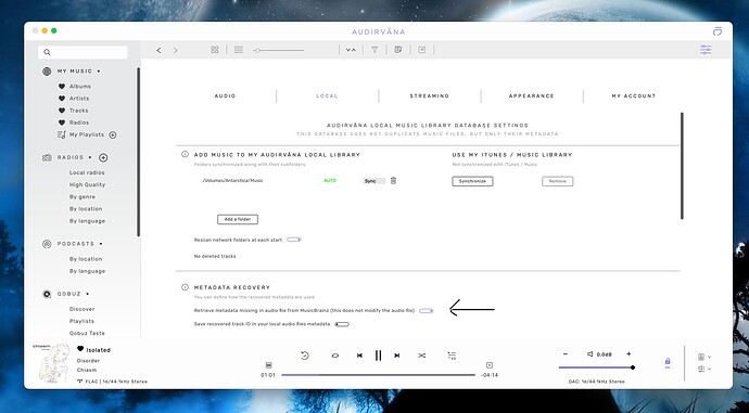

Is this option turned on or off with your Audirvana?
It’s on by default. Just learn of this setting… Is this the cause of this behaviour?
Maybe. It’s turned on here as well. But the description reads that Musicbrainz adds information to AS’s database without changing the original file itself.
Sounds to me why some information shows up in AS this way but does not do so with other music programs.
