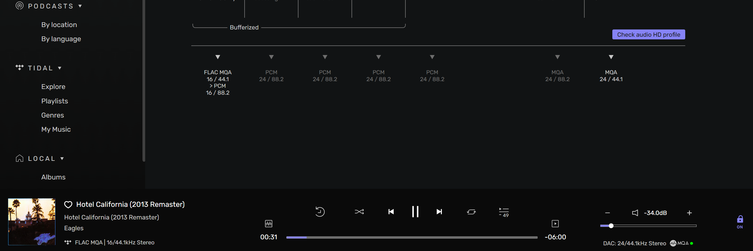

So it seems that there have been an issue with MQA identification and we have made a fix for it.
For everyone having this issue, please try the test version you can find here
Thank you @Antoine . I can confirm with this test version the output of the original 16bit/44.1kHz is correctly identified as MQA and the magenta light on my DAC is turned on.
Just one thing: the output audio stream is displayed as 24bit/44.1kHz instead of the original 16-bit.
Since you have a MQA Renderer, the first unfolding is done in Audirvana, and no other audio processing is done as the DAC is doing the other unfolding. But the unfolded of the signal need to be sent in 24 bits to convey all the MQA data.
