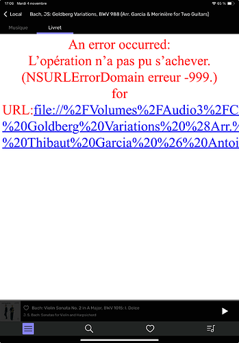

4- Flutter (if that is a correct word to describe the situation) affecting viewing of booklet that sometimes put you back on the very first page or produce an error message (cannot read the booklet).
To be noted that the flutter also affect the progress bar that is refreshed every second. It also (not 100% sure though it is related) randomly move the album covers on the remote when browsing through the list.
This appears very frequently.
===> Current fix: none.

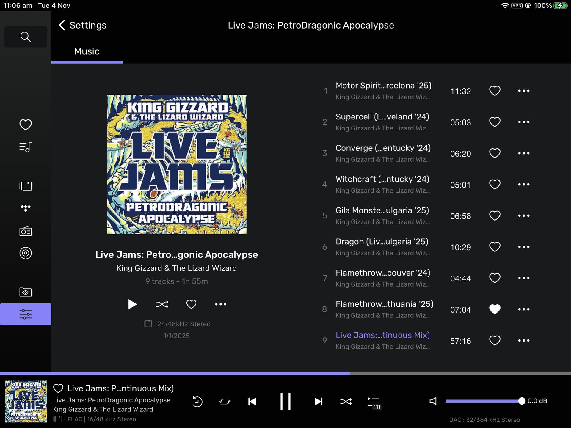

Hi @patifr Can help i hope with a few of your issues.

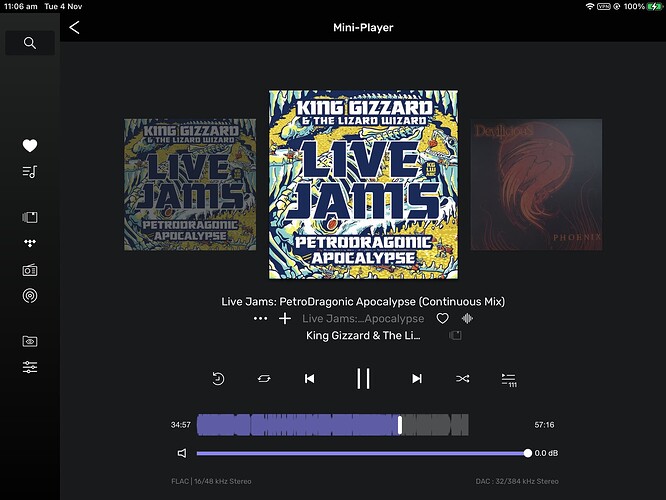

Issue 5
From iPad Remote - A couple of Steps. Press the Album Details on Bottom left.
Press the 3 dots beside the + and select show album.
Album Shows PS The second and third screenshot are out of order. Oops.

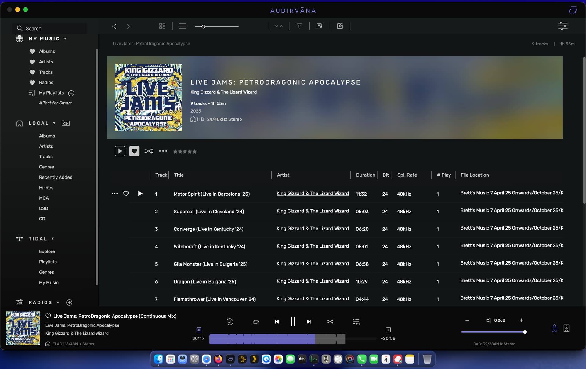

From Audirvana on Macbook Air
One step only. Click the Album Name in the information area at the bottom left. Takes you straight to Album.

OK, I will send you an example of such a booklet. This happened in several cases, but I’m not sure this occurs all the time. I will also try to catch the precise error message.

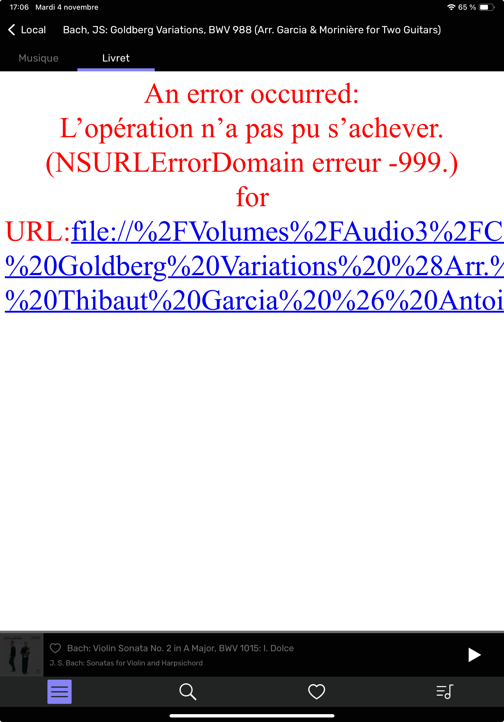

Regarding the issue number #4, I found by chance a booklet on which the problem occurs but i’m not 100% sure this is due to the booklet itself (Not a big one by the way: only 800KB of PDF).
The observed behaviour randomly occurs with a flashing screen and a reset of PDF display back to page 1.
In addition, from time to time, there is an error NSURLErrorDomain that appears with an error number I did not catch due to flashing screen.
This could be due to WIFI but this is strange as I am very very close to the WIFI router…
@Antoine
Goog news, so to speak! I managed to trap the error message that appears sometimes when reading a booklet.
That time it appears on another booklet with a size of 1.6MB. According to what experts on the Web say about this error, it’s due to server closing the connection or something like that. Maybe a problem on the NAS side? I will try a reboot…

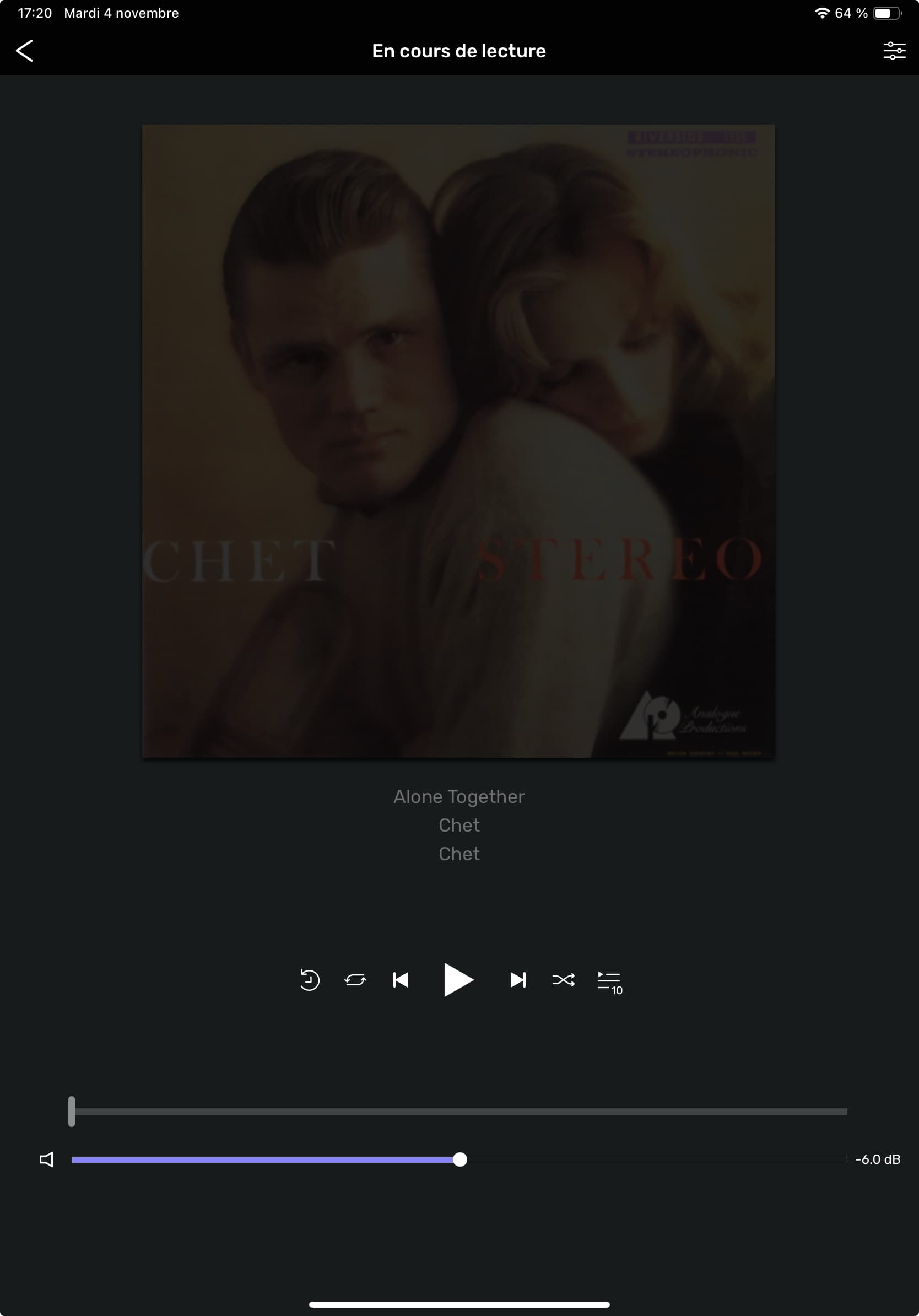

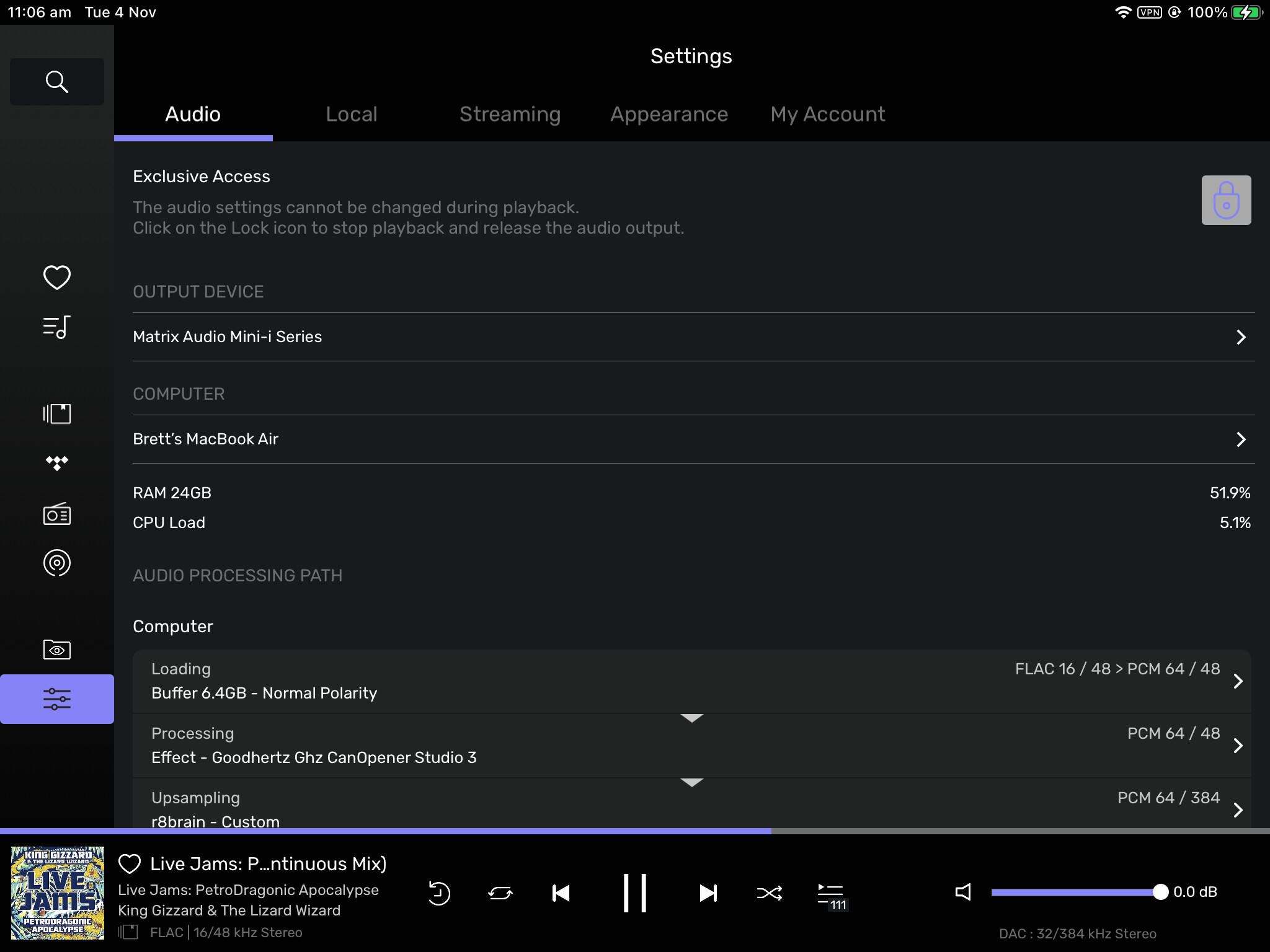

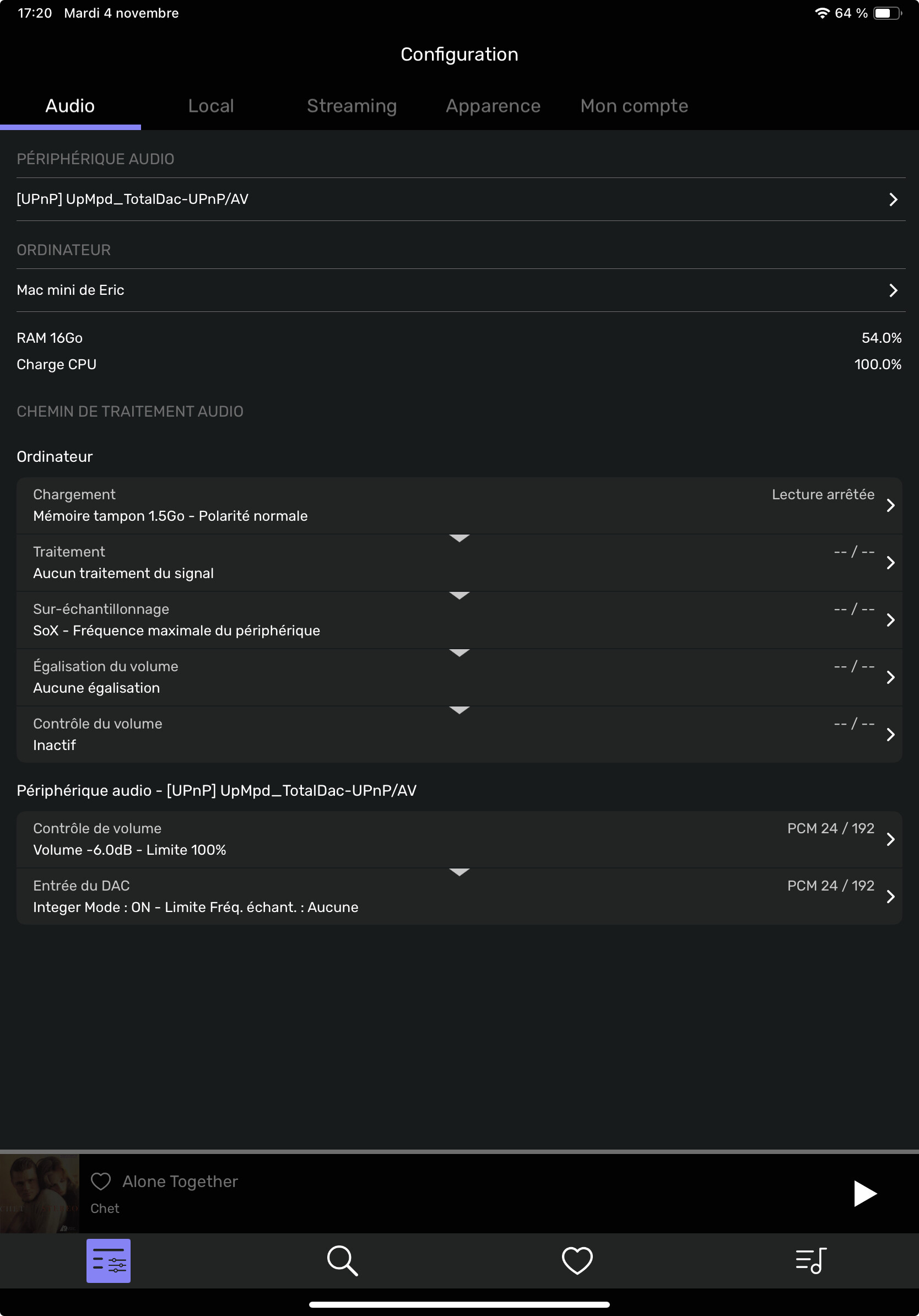

And regarding the issue #5, I tried to find the three dots option on the currently playing track and could not find them…
Here is the starting point: configuration screen:
Then, I clicked on the album title at the bottom left of the screen and here is what I got: no three dot option…
