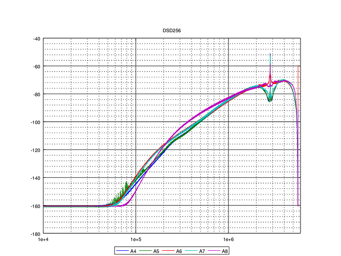

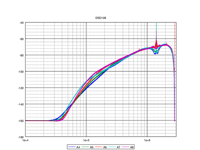

Type A comes in different orders (4th through 8th). Higher orders push more noise to higher frequencies outside the audible range but can affect timing and natural sound:
  • Type A (4th order) consistently provided the most natural, engaging sound in my tests
  • Higher orders (5th-8th) created a “blacker” background but introduced strange artifacts – acoustic guitars lost focus, bass became woolly, and orchestral strings started to sound more like a synthesizer than individual instruments
  • The tradeoff became clear: increasing technical “cleanliness” at the expense of musical engagement

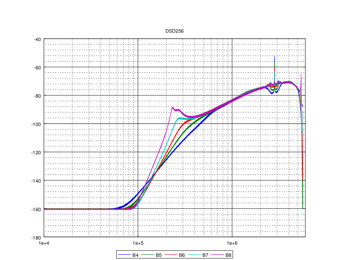

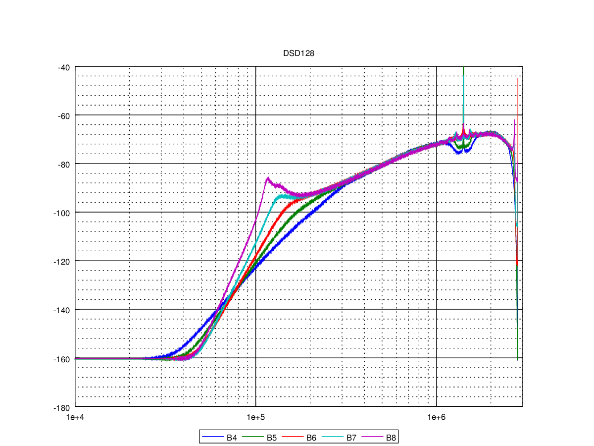

Type B takes a different approach to noise shaping that is more aggressive in the midrange:
  • It offered an interesting alternative – wider, deeper soundstage but lighter tonal balance
  • It seemed to create a “hole” in the lower mids that made music sound less emotionally engaging
  • While it cleaned up some “confusion” in orchestral mids, it made music sound too “lightweight”

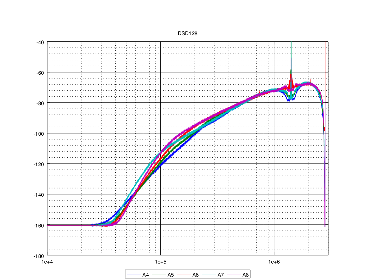

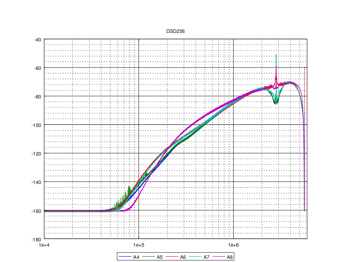

Here are graphs of Audirvana’s modulator noise profiles at DSD128 and DSD256, as measured by the modulator developer. (He didn’t provide graphs at DSD512 IIRC.)
