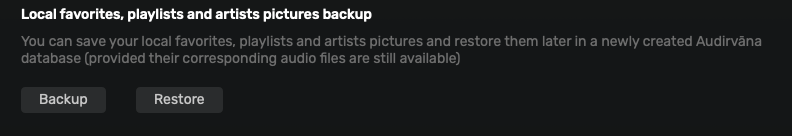

Should I try trashing the preferences and re-installing? My favorites and playlists are all on Qobuz and I don’t use AS for my local library, so I don’t think I’d lose anything.
That’s always a solution and you could make a backup of the settings nonetheless by making screenshots and/or copy the debug info before you do so.
