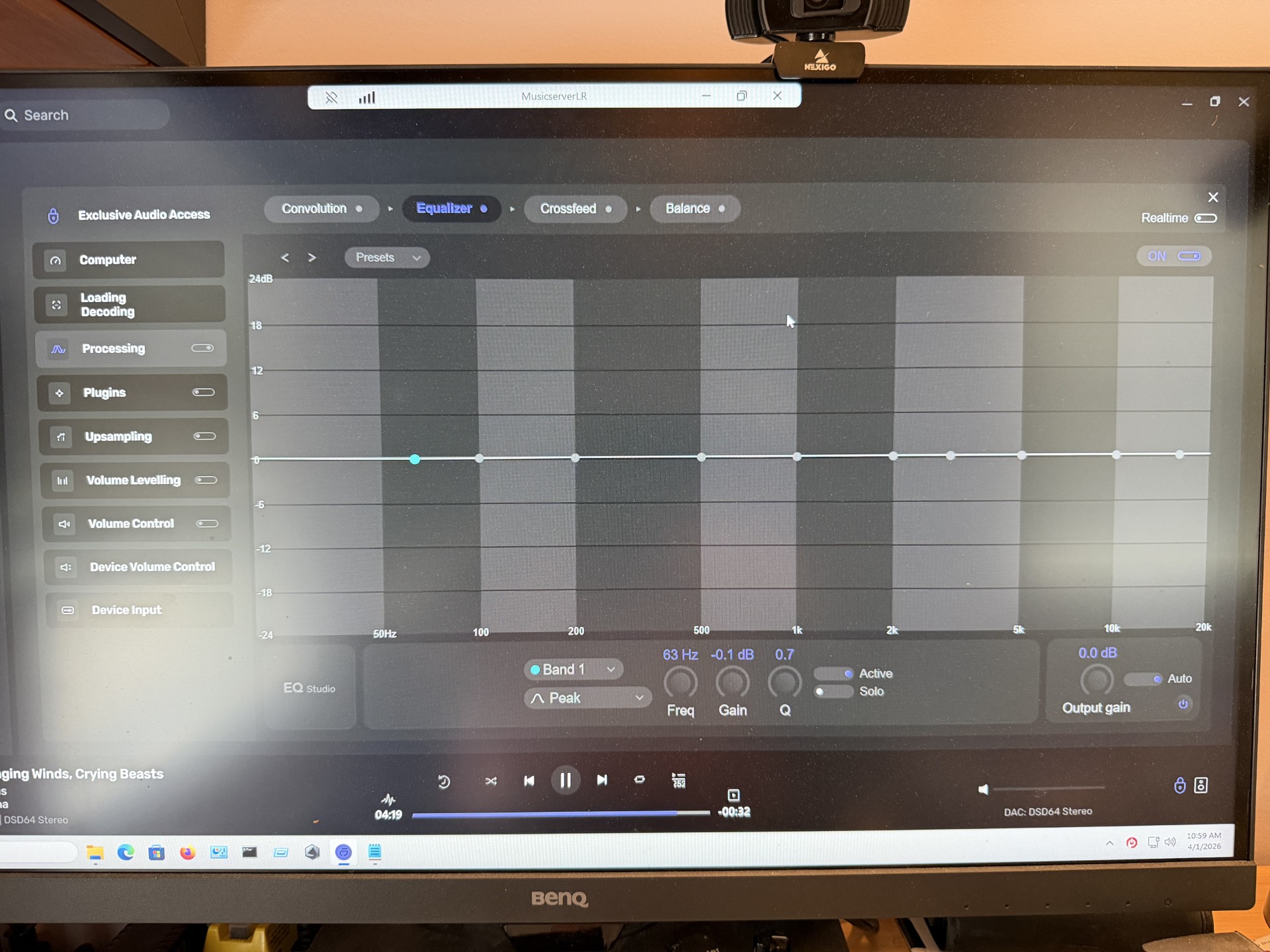

Can you send a screenshot of the settings you have in Audirvāna Studio EQ?
PS just to eliminate possibilities and gain knowledge, I want to try it first with another upnp device. Stay tuned.
