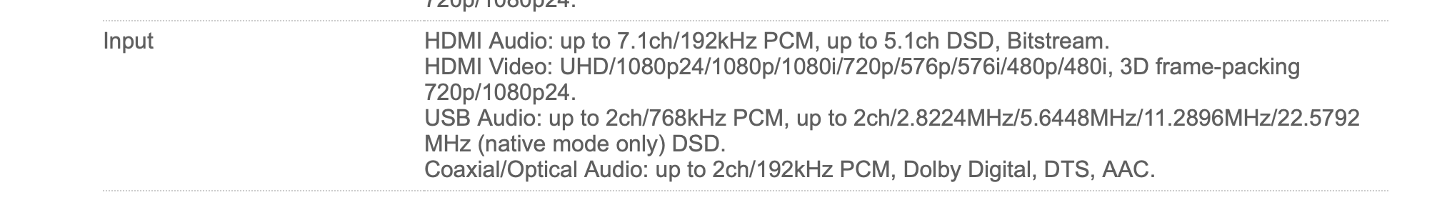

I have a doubt, using the Mac with IOS I can use it without a problem until DSD128.
When I try to use DSD256 it works, but it fails.
I use the DAC of the Oppo 205 that goes up to DSD256.
I’m using a Mac mini I5 with 8GB of memory, an exclusive computer for audio.
Is this a problem with the processor or Audirvana?

May be a signaling issue over your network to the Oppo? Does the Oppo play DSD256 with direct USB?
Yes, Oppo plays DoP DSD256 directly on USB.
The problem is that it has small glitches during music.
With DoP DSD128 works perfectly.
