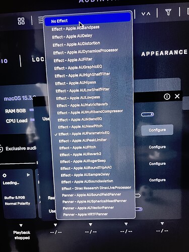

I’ve got two other question. 1: I thought i could implement a REW filter into AudirVana, but I don’t see the option here. I read that this should automatically become visible here.
I’m doing something wrong I think,… but what?
2: It won’t play tracks in a playlist sequentially. It stops after one track. Then I have to klik on the next track, after that track is done it stops. Ect ect.
(Yes, AutoPlay from the last track is ā€˜On’)
What’s going on here?
