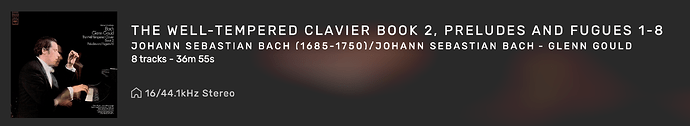

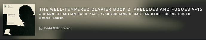

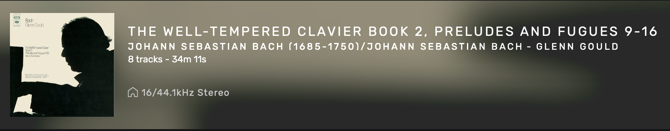

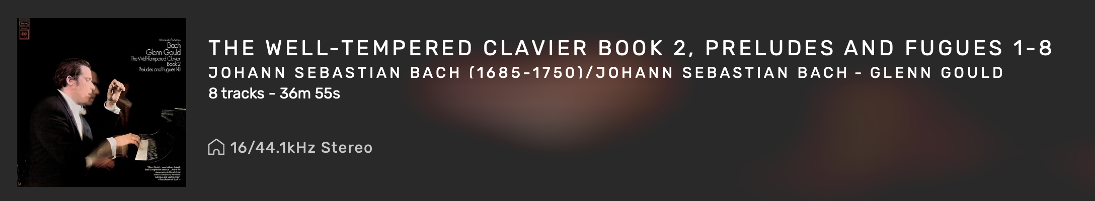

I redid my test after installing 2.5.2: I played two albums consecutively pressing the start button on the first song of each album and letting the album play to completion. I should add that all my files are Apple Lossless audio files.
After loading the first song of the first album memory usage was 962 meg. After finishing the first album memory usage was 1.3 Gig. After releasing the lock on my DAC, memory usage was 199 Meg. After loading the first song of the second album memory usage was 1.03 Gig. After finishing the last song of the second album the memory usage was 1.15 Gig. After releasing the lock on my DAC, memory usage was 210 Meg.
