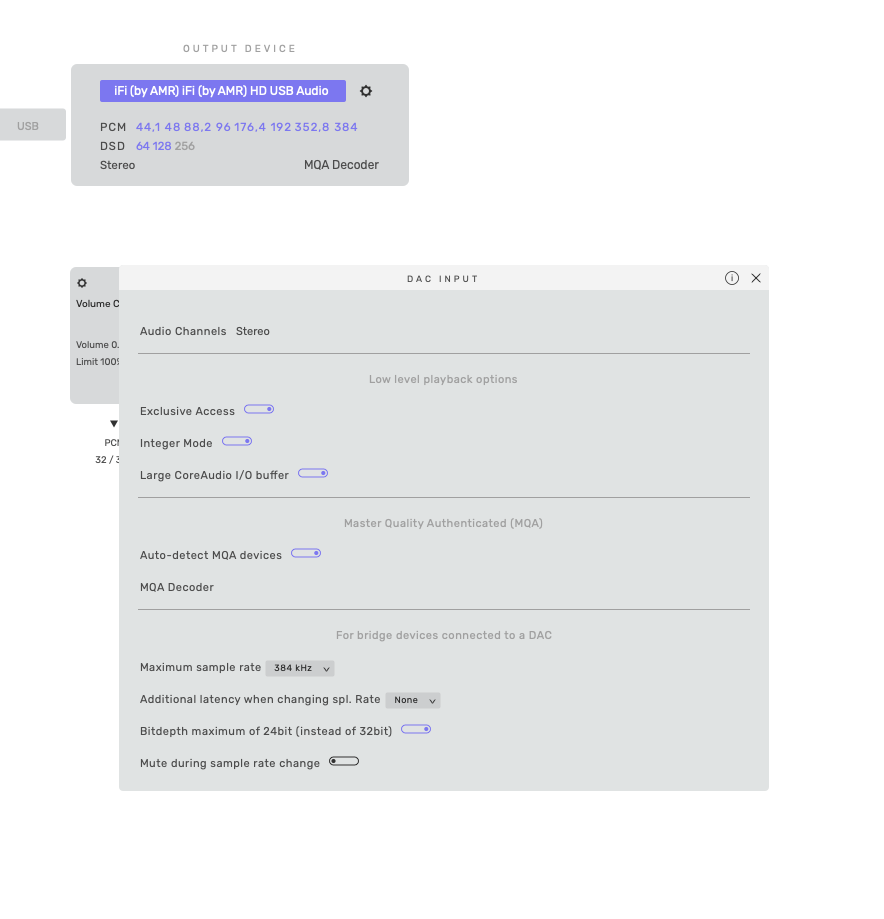

Is this also the case with my iFi Zen DAC V2? According to the specs it should support DSD 256, but it’s greyed out in AS. Not that I have DSD files to play, but still.

I see. I have an M1 MacBook Pro connected to my iFi DAC, which is running AS. I have no idea where to check if I’m using DoP to be honest. Maybe I’m missing something.

In dac little gear wheel you have to select dsd oven pcm 1.1 option to enable dsd256 1.0 stop at dsd128.

That option is not available here it seems.
euh… strange. If you turn off MQA does it appear?
You are plugged with USB?
why you put a sample rate max and the bit depth max too?
I’m connected through USB. It’s actually the only connection the DAC has. No matter which setting I try. The PCM option does not appear. MQA has no influence either.

Well updated the firmware to the latest version (7.40 with MQA decoding) and no changes in AS settings.
There are 3 options available
