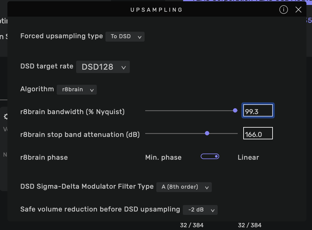

You can leave the up-sampling settings operational… When you play DSDxxx the up-sampling is bypassed, so no need to go in and switch it on or off…
Set your up-sampling type “to DSD”
Try these settings for r8Brain:
You probably don’t need to reduce the volume -2dB… I do this to match output level with the native DSDxxx (D0P) playback levels that don’t get up-sampled (modulated) on my DAC/HPA system…
Ok, kept the volume at -3 dB. And I’ve set the other settings as you’ve suggested
