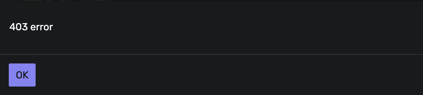

I’m trying to post my solution for issue #1 but keep getting the following:
And then this when clicking “Reply” button:

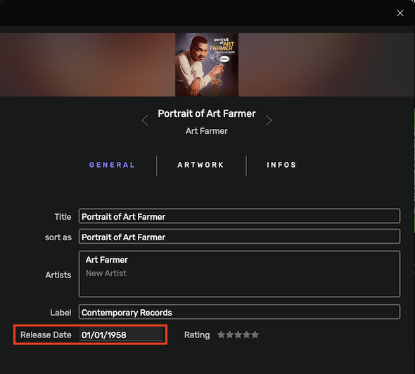

My solution to make that ‘Release date’ tag sticks
is to write that tag THE LAST THING you do in the tag editor window.
if you change something back in an album 1970 and older the tag will vanish,
you have to reenter it again as the last thing saved.
As for making album in order when many same date, i put a number higher in the day filed…
01-01-1970, 02-01-1970, 03-01-1970

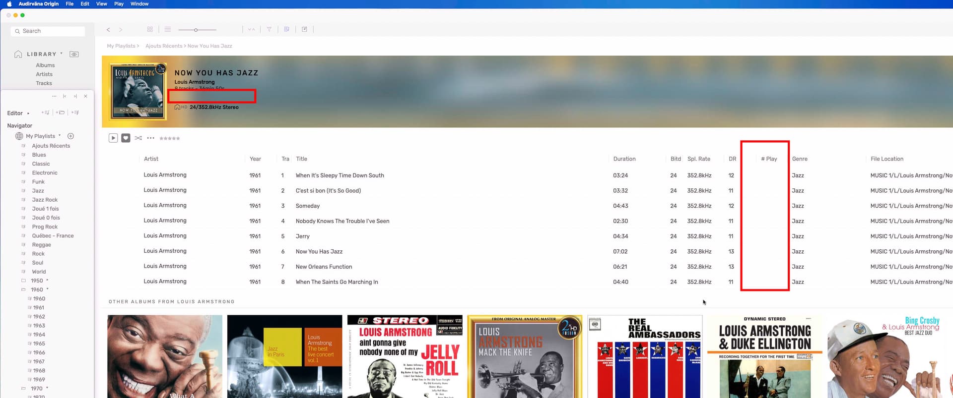

i just put one 1961 album on my desktop,
trashing the one in the Louis Armstrong folder…
sync remove that album from Audirvana
i put back that same Album in the Louis Armstrong folder
where it was 30 seconds ago…
Lost my Release Date and my play counts…
and this album now is in my recents albums playlist, like new :frowning:
If you do the same with an album, you will NOT lose
your release date ? and play counts (if you use that)
If the audio files contain the Release Time metadata field (I use Yate for metadata editing) then you wouldn’t lose that. The trigger I added to my database reads the tracks’ tag’s value in the database and properly updates the Release date for the album in the database when you add the album (for albums <=1970).
You would lose the Play count as this info is only in the database.

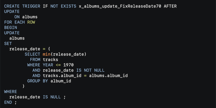

In my quest to resolve the “1970” issue, I created a new trigger in my database that properly sets the album’s release_date from the tracks release_date in the database when adding (or updating) the album to AO.
I’ll preface the rest of this post with the following:
  • Before editing a database, make sure the application using it is not running.
  • Always, ALWAYS, ALWAYS make a backup of your database before editing it, in case of mishaps.

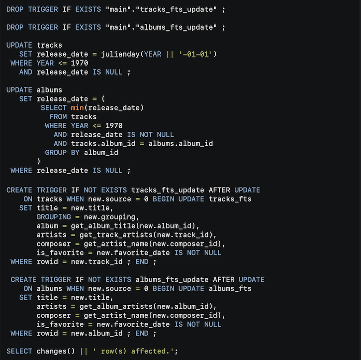

  • This Discourse powered forum won’t let me post the formatted SQL code (because obviously I’m attacking the server with malware!), so I provide a picture and a link to an online paste bin.
I use DB Browser for SQLite :arrow_forward: https://sqlitebrowser.org (free SQLite database editor for Windows, macOS and Linux) to modify the database, executing the following code:
:arrow_forward: dpaste: D88FSJJ2X
Now, if one wants to update their existing database without having to create the Release Time tag for all their audio files, then the following SQL commands can be executed.
The following will (for albums from 1970 and earlier):
  • Create and populate the tracks’ release_date field computed from the Year if no release_date data exists for the tracks in the database.
  • Populate the albums’ release_date from the tracks’ release_date
  • Return the number of changes made
:arrow_forward: dpaste: 3UH4MC37E

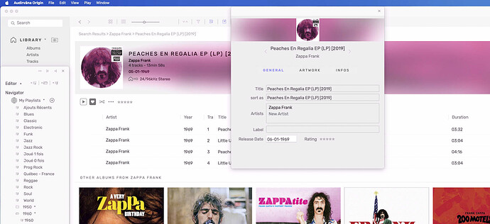

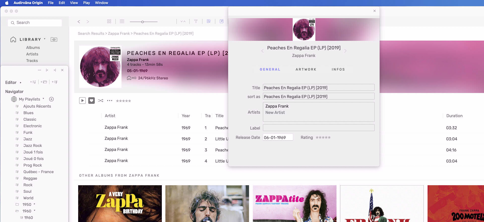

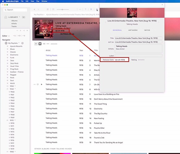

Result:
Just a note…
In my testing, when using something like “01-01-1958”, then only the date’s year will appear in the UI (as my pic above and my preference) whereas if using anything other than “01-01-XXXX” (ie: “03-06-1958”), then the full date will show.

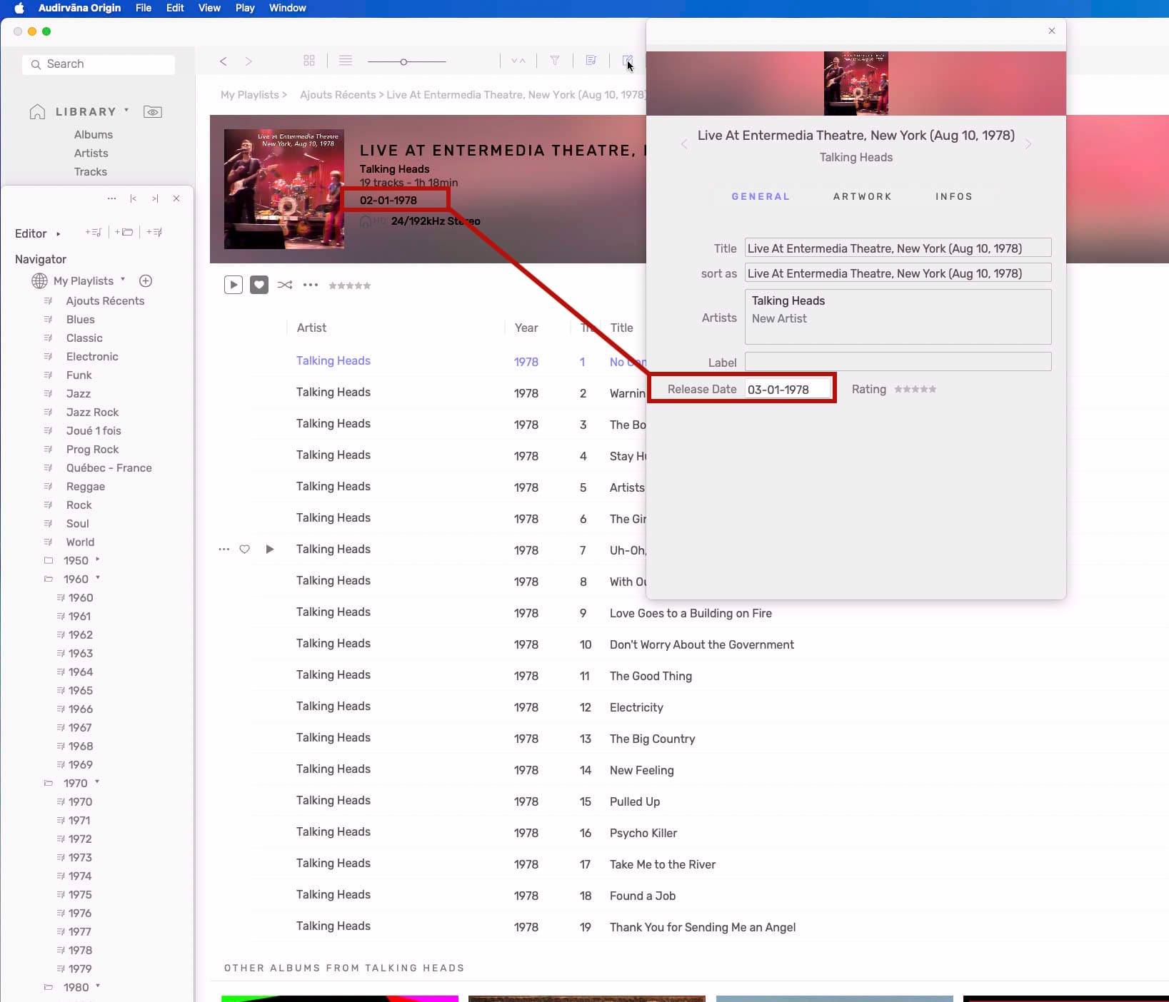

Also when you wrote the Release date with other numbers than 01-01-1970
like 03-01-1970, Audirvana show the date as one day before 02-01-1970 ??
Can’t remember where i saw this, but it use December 31, 1969 to show 01-01-1970 (France time ??) Again, what a mess this tag thing.
