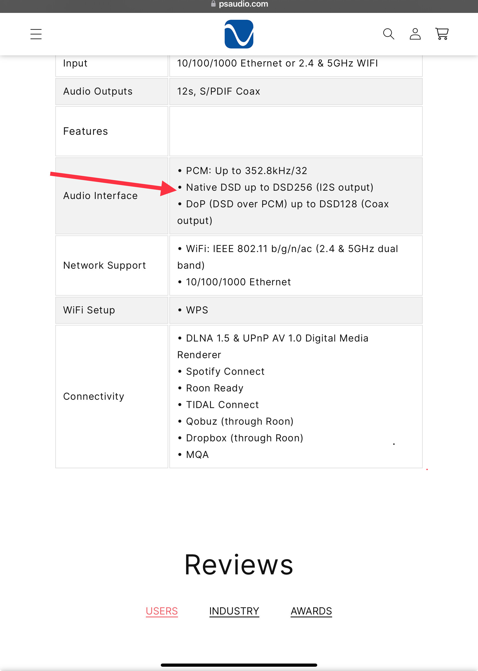

You see in the screen-shot that the MKII supports 705.6kHz which is the PCM DoP carrier sample-rate for DSD256 (11.2MHz)… The AirLens does not support 705.6kHz signals.

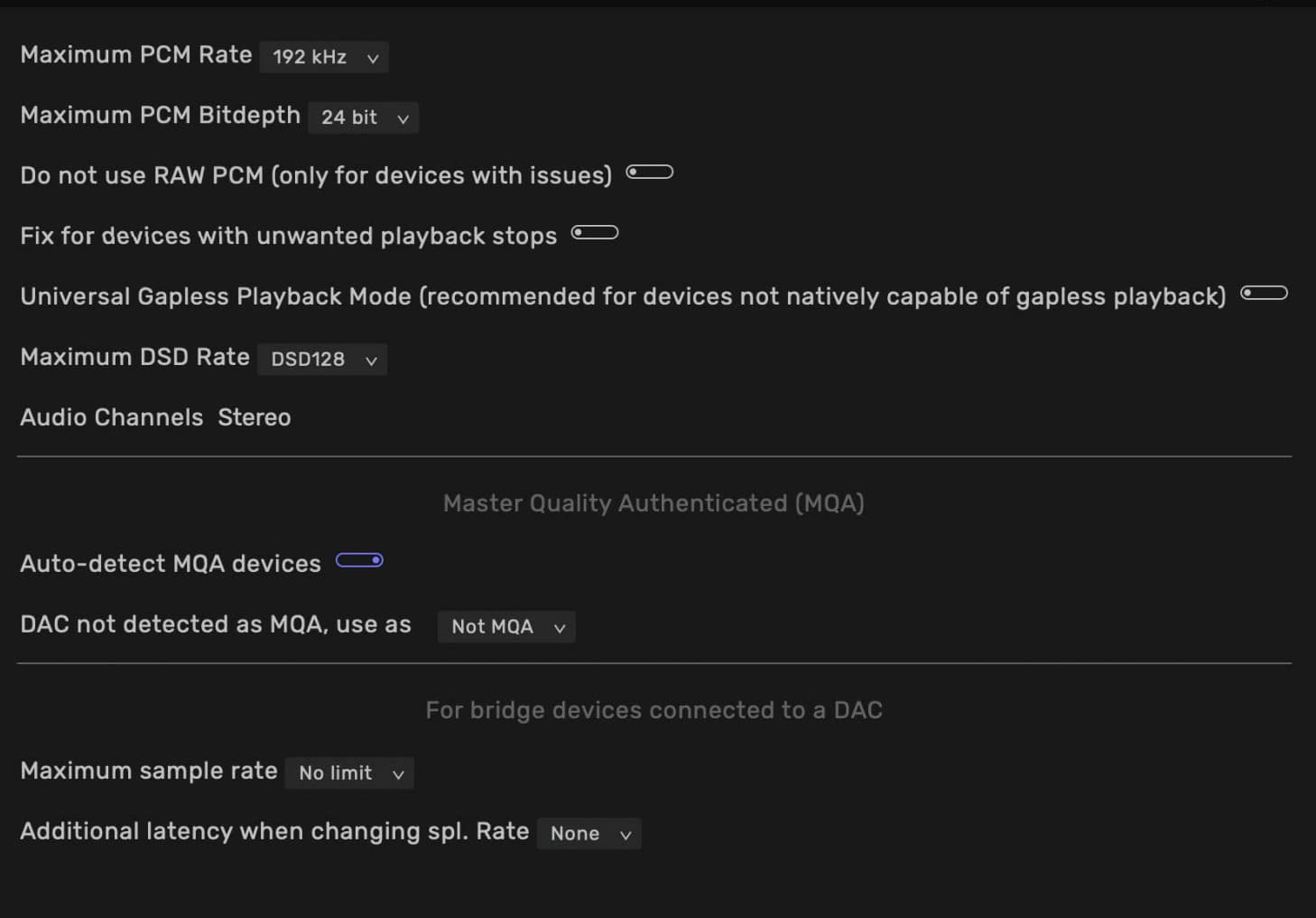

Here is the screen shot.
So the debug report tells you something… Does this reflect the specifications of AirLens?.. it does not …There is something wrong here… Is the firmware updated? You see that ā€œDSD Capabilityā€ is raw DSD (msb) in the ā€œActive method: UPnPā€ configuration.
The reason you are not seeing ā€œNative DSD streaming methodā€ is because Audirvana is not seeing the AirLens as supporting DoP…
You have set the Maximum PCM Rate to 192kHz…The DoP PCM carrier sample-rate for DSD64 (2.8MHz) is 176.4kHz, the DoP PCM carrier sample-rate for DSD128 (5.6MHz) is 352.8kHz… Audirvana is converting all DSD to PCM for playback because it does not see the AirLens as DoP capable… Make sure the AirLens is set as the output device in Audio MIDI Setup and set to the maximum sample-rate and bit-depth of 32 bit/352.8kHz.
Why Audirvana is not seeing AirLens as DoP capable and limited to PCM 192kHz is something to ask PS Audio and maybe the Audirvana team can add further insight.

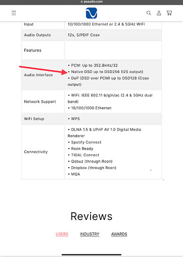

Also, please look at the 2 specs.
I take it it’s native, no need for DoP.
You mean like this?
Yes exactly.

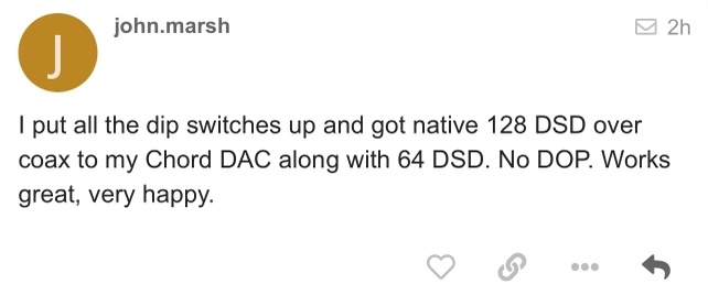

There is someone on the PS forum talking about using coax to play DSD 128, No DoP.
DoP

Have you experimented with these settings as @Antoine suggested? These can make a big difference.
