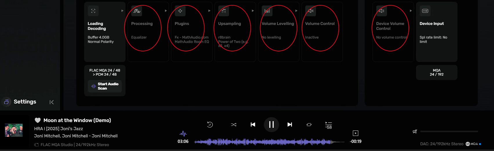

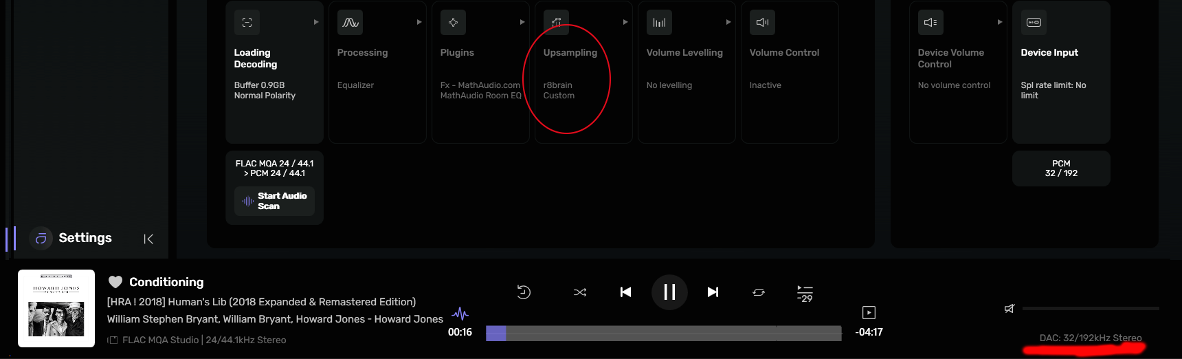

Regarding Audirvana’s settings panel:
Should any greyed-out instance regarded as being completely uninvolved in the current process? See the red marked parts of the attached screenshot: Should/can they all six be regarded as completely in-active in the given situation?
They should be completely inactive in this situation.
But it seems to me they are not.

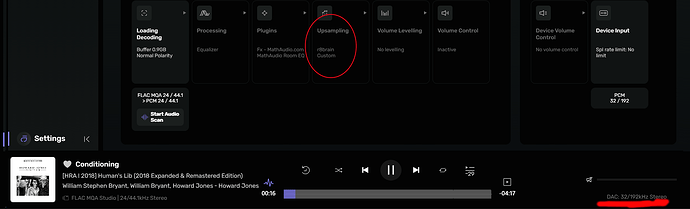

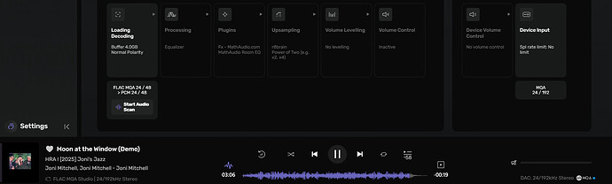

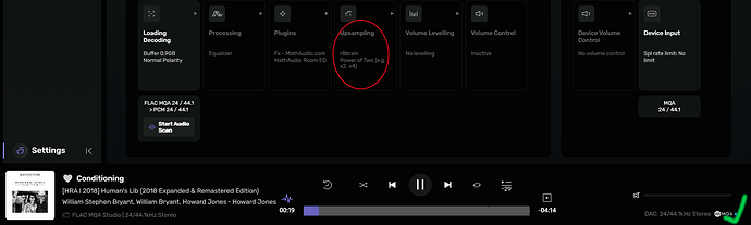

See these two »MQA screenshots«:
• One is with Upsampling setting »Power of Two …« and with a fine MQA handling
• The other one is with Upsampling setting »Custom« and with corrupted MQA handling
It’s what I thought, but I need to reproduce this on my end.
It appears that you have an illogical ‘Custom’ strategy that may be playing into this weird behavior…The strategy appears to up-sample 44.1kHz files to 192kHz, which is not a logical target… Why this would have influence…? That’s a good question if in fact, that illogical strategy is the culprit… (When up-sampling is disabled)

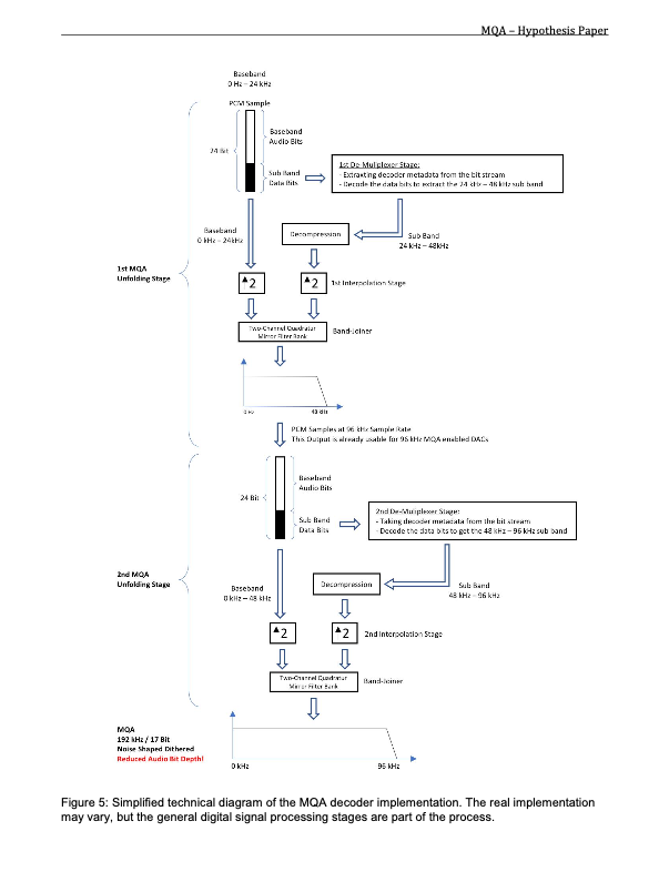

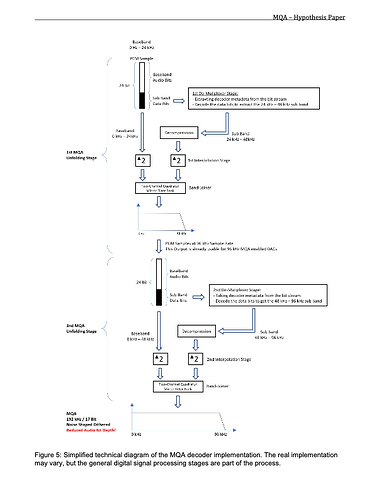

Something is going on with the MQA decoding processing in Audirvāna… I am guessing here, but it appears the operation is looking at the up-sampling configurations and reacting to the logic applied… What we do know is that the first unfold is typically not allowed to be up-sampled beyond 2x the base-sample rate result… So if this is the case, ‘Power of Two’ in the context of this particular DAC capability, would be prohibited because the 768kHz result would violate the 2x restriction… In the case of the ‘Custom’ strategy, the result falls within the 2x restriction window and allowed, and as a result of the bit-depth and sample-rate conversion, the MQA metadata is destroyed. I think we can presume if the ‘Custom’ strategy is set to “one-one” defaults, OR if no up-sampling algorithm is selected in any scenario, there would be no processing applied and the first unfold signal will be passed along with the metadata intact.
Based on this simplified overview (below) of the MQA decoding processes, I presume in the case of this particular encoding, that within the architecture of the MQA encoding process the first unfold is the MQA 24/192kHz reference file with the metadata instructions needed for proper playback in the specific MQA DAC architecture. :thinking:

Maybe it was never considered that folks would ever apply up-sampling DSP to MQA files… Have you tried selecting “None” as the ‘Forced Upsampling type’ ?
You obviously don’t understand. Any DSP settings I did have been done based on the (obsolete?) certainty that they would be bypassed during MQA and DSD processing.

As you can see, you have other DSP process disabled and they do not affect the MQA file… So, if you have ‘Forced upsampling type’ set to “None”, we would expect the MQA file to be unfettered.
