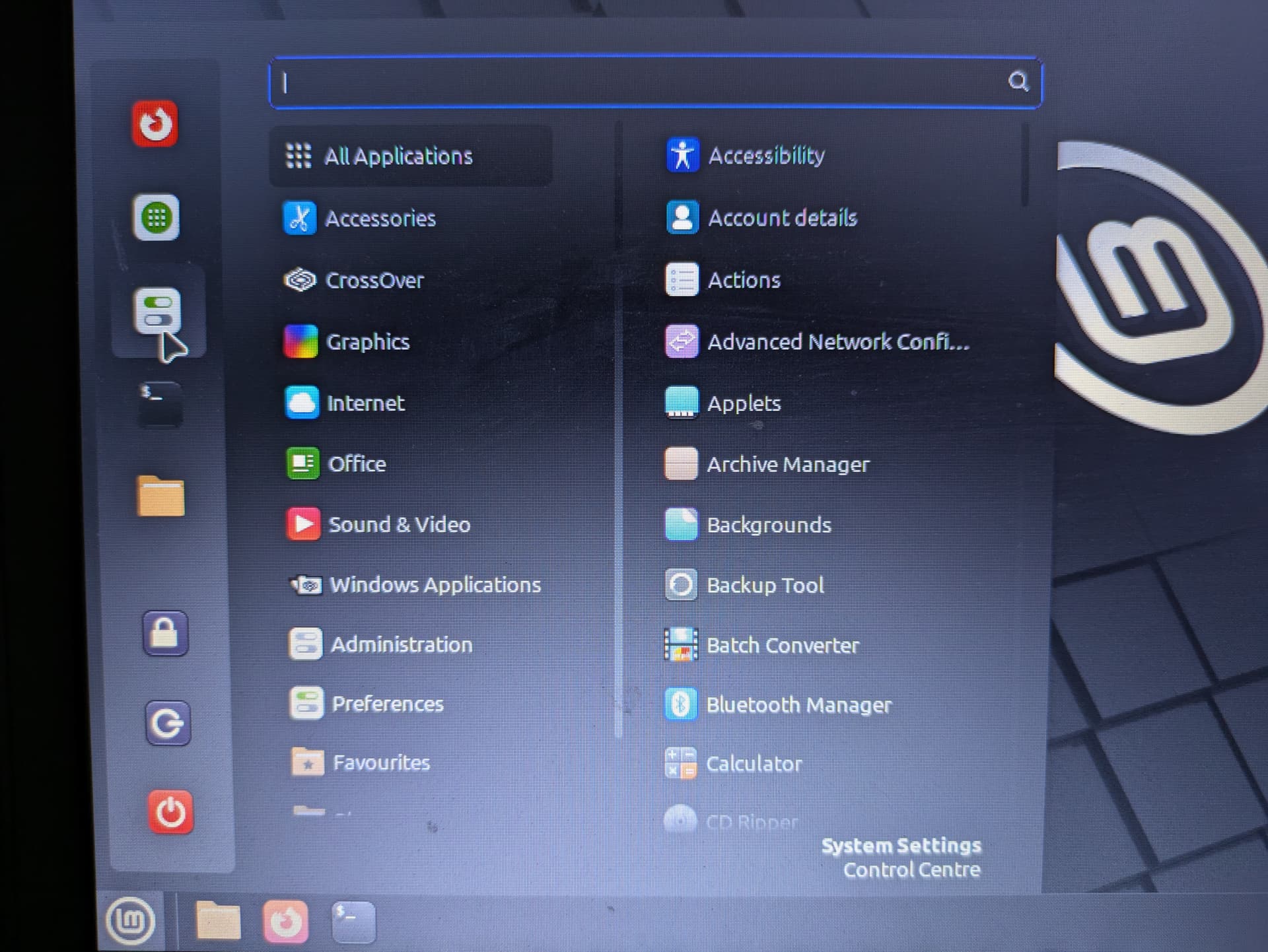

i installed the packet on my server , but there is something wrong , the Audirvana for linux doesnt starts , my phone dont see the core. I didnt understood if it is necesary a wifi card on my server to work…
Have you set it up that Audirvāna automatically starts? Or have you clicked the icon in the Opt map?
I dont understand how to do to start automatically at boot,

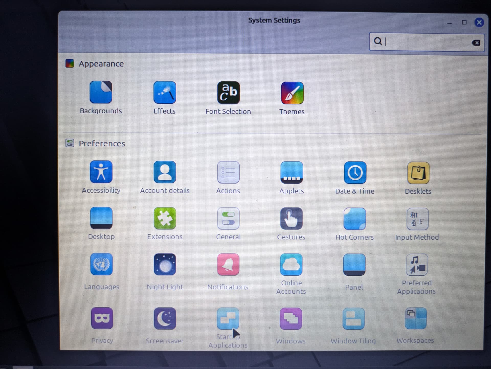

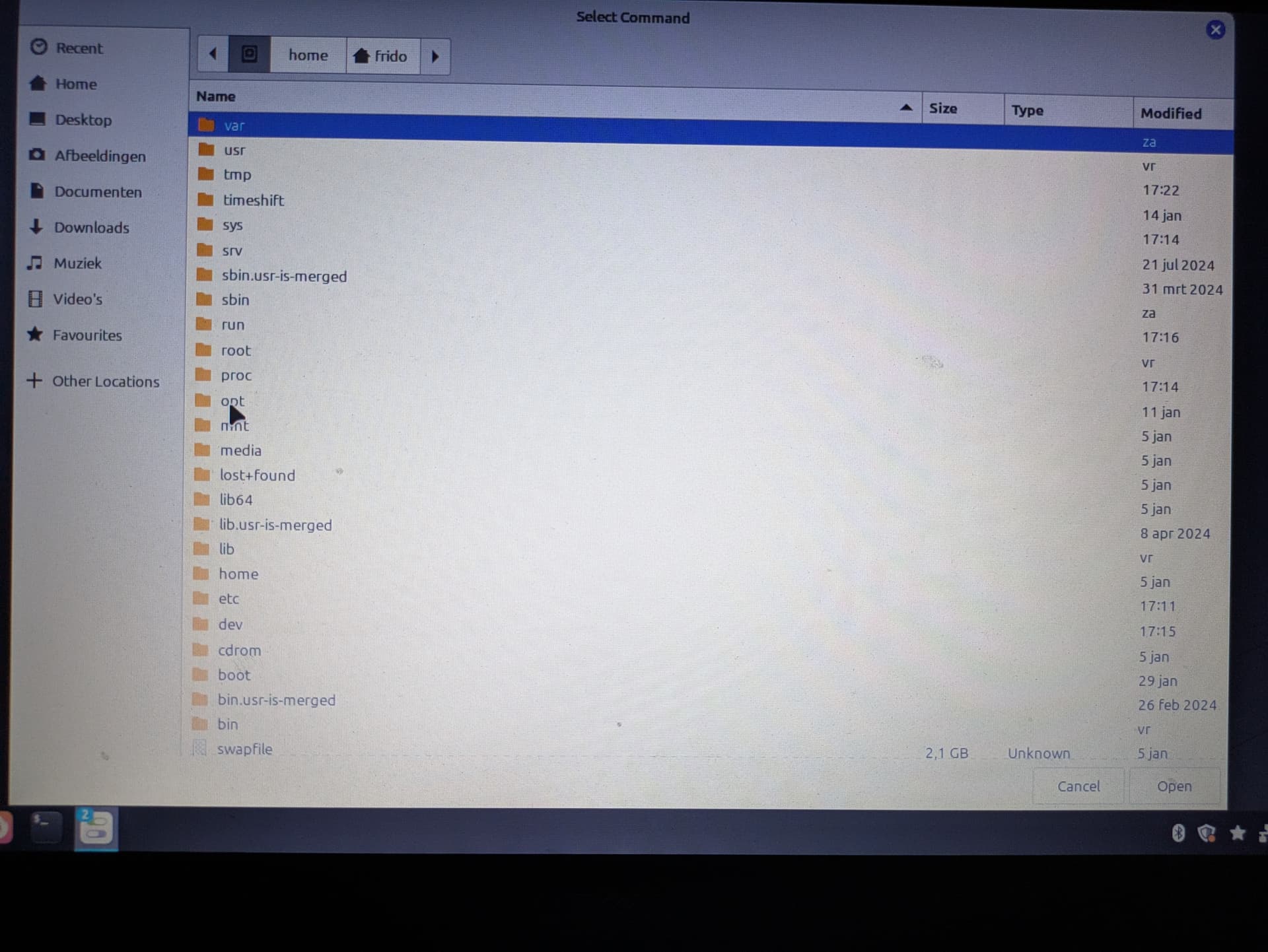

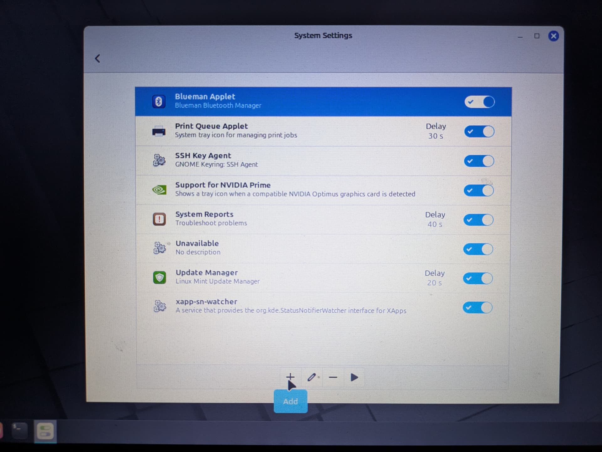

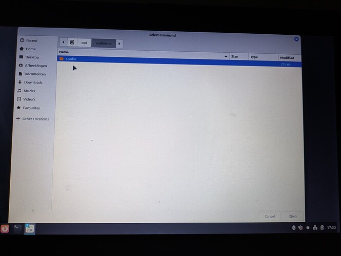

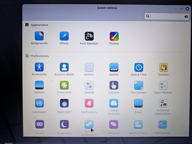

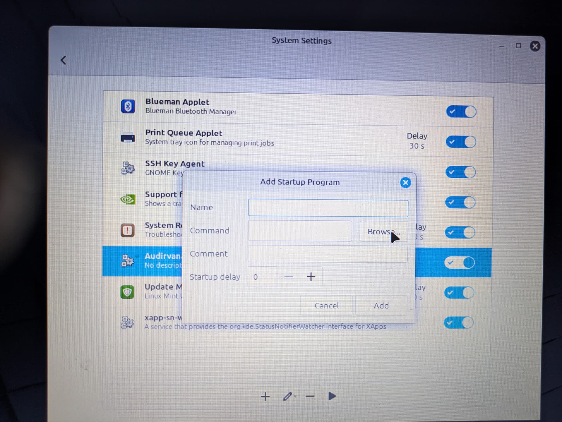

There are some options for that, and in Mint an easy one. I’ll post some screenshots in a couple of minutes.

I guess you haven’t run the command:
sudo /opt/audirvana/studio/setAsService.sh enable
and
sudo /opt/audirvana/studio/setAsService.sh start
from the Command Line (the terminal) in Linux.
ok, I will try this commands and tell you later, thankyu so much for your help sir
