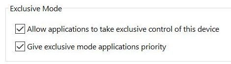

This helped me: turn off the Realtime Control
MUTE DURING SAMPLE RATE CHANGE set to ON might help. also play with delay of sample rate change ( 0,5sec for example).
Do you mean unchecking the box in Windows that says “Give exclusive mode applications priority”?
