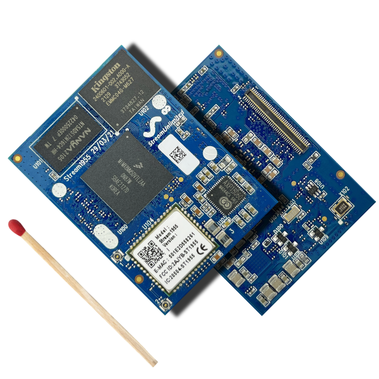

AFAIK, Lindemann Audio use for their devices the streaming boards of
Stream Unlimited:
Looking at these specs they seem not to use the latest streaming board (Stream1955) for their devices but the older one (Stream1832) which has the lower ethernet specs.
