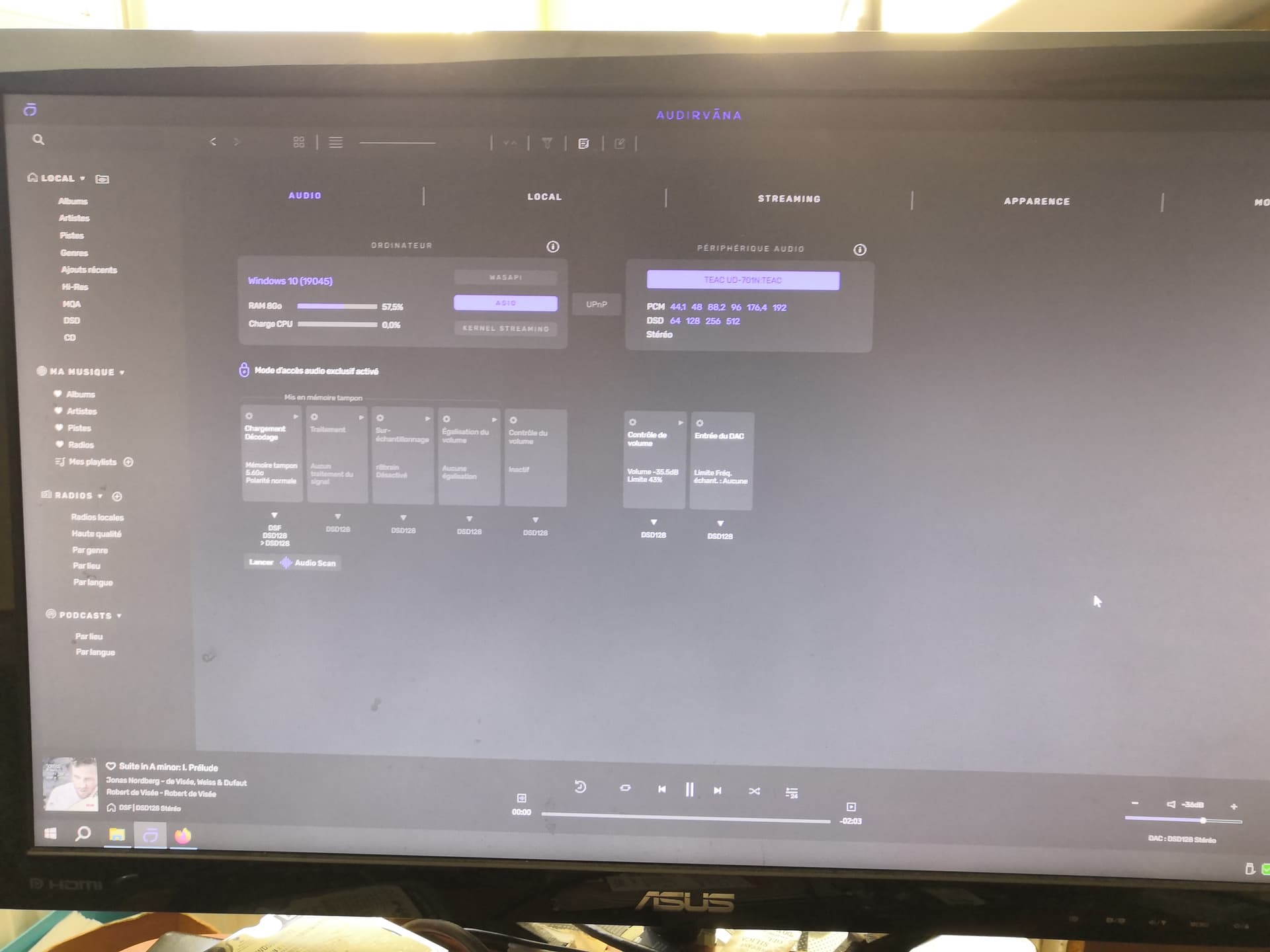

Her you are the screenshot of Audio tab of settings.
IMG_20230916_182052|666x500.
It doesn’t work with Asio either.
Once again, sorry I am not familiar with Audirvana on windows. When you click on the TEAC in the audio settings page do you not get a window opening with the settings for the DAC as you do on a Mac? On a Mac I would get a dialog box opening with options to set the max pcm sample rate and DSD settings I.e “non convert to pcm” or “DSD over DoP 1.1” amongst other options……
You need to ensure you either select kernel streaming and use DOP1.1 or if you use ASIO have the correct ASIO driver installed as far as I am aware. But again I last used a windows machine in the days they shipped with Windows XP.
