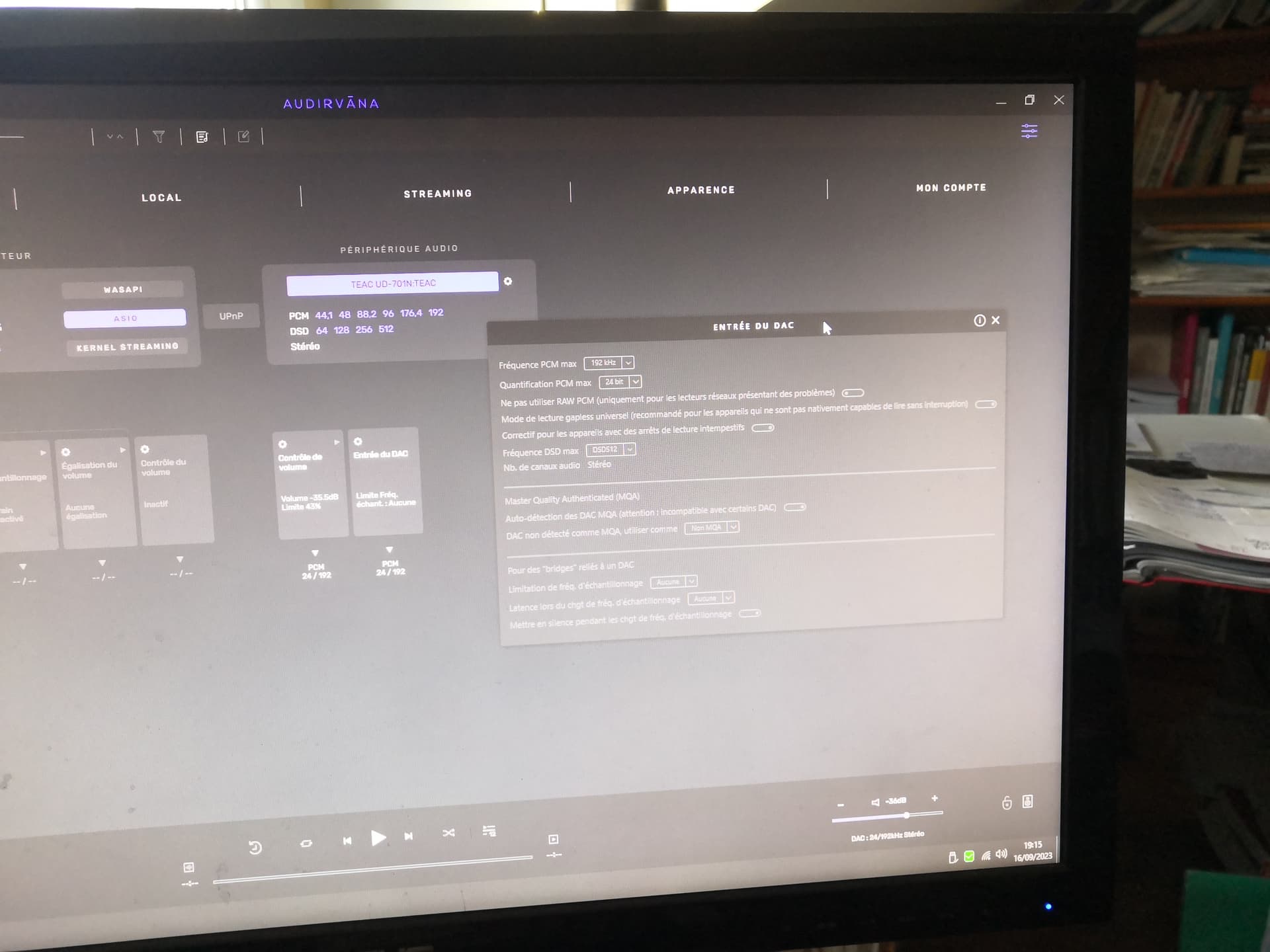

See screenshot of TEAC 701N settings.
DSD over PCM1.1 is only available if native DSD is not available on the Dac (e.g. on my Asus VS278 display).

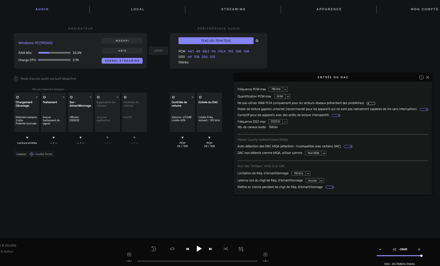

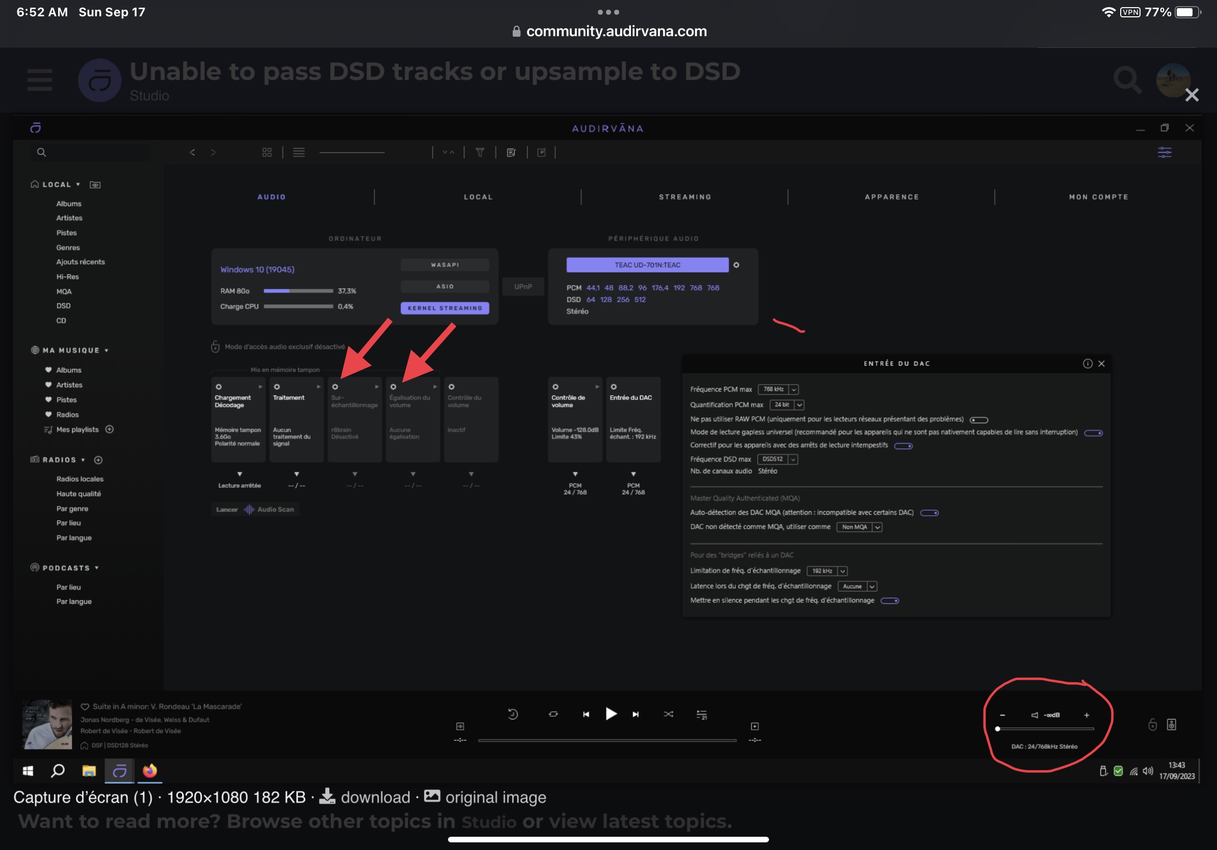

Here you are.

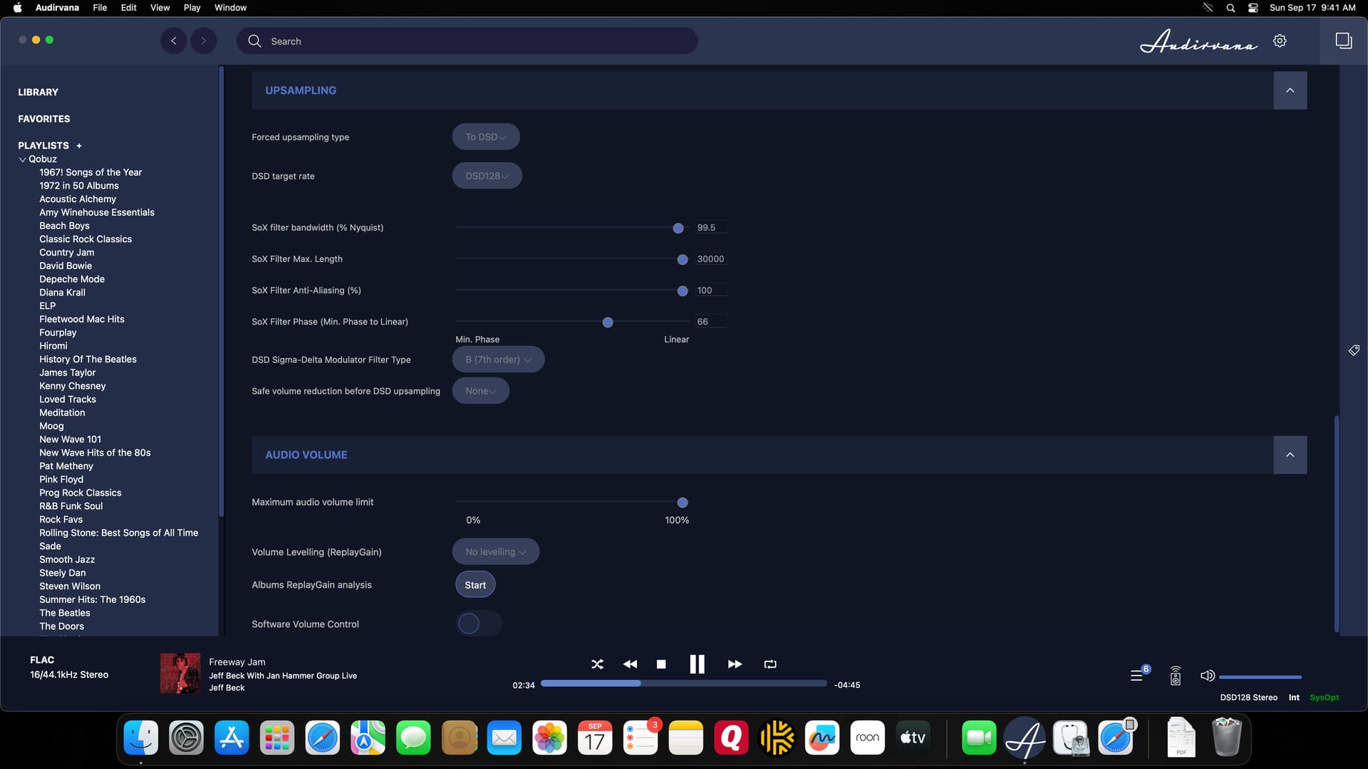

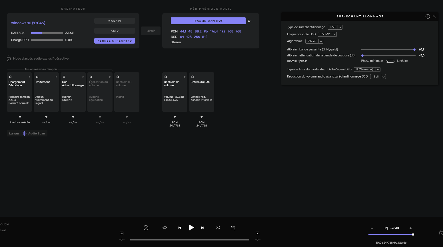

Just like the other guy’s I’m not a windows user, these are just some things that you could possibly give a try. Now you have a screenshot to show what you had settings before. Maybe try setting volume to fixed at 100% unless you have no other option to adjust volume. The setting to the left of the volume settings could you open that and choose r8brain and see what other options are available then. Post another screenshot of that open please. I’m a bit grasping at straws but if you want we can see more of what you might change to make an improvement.

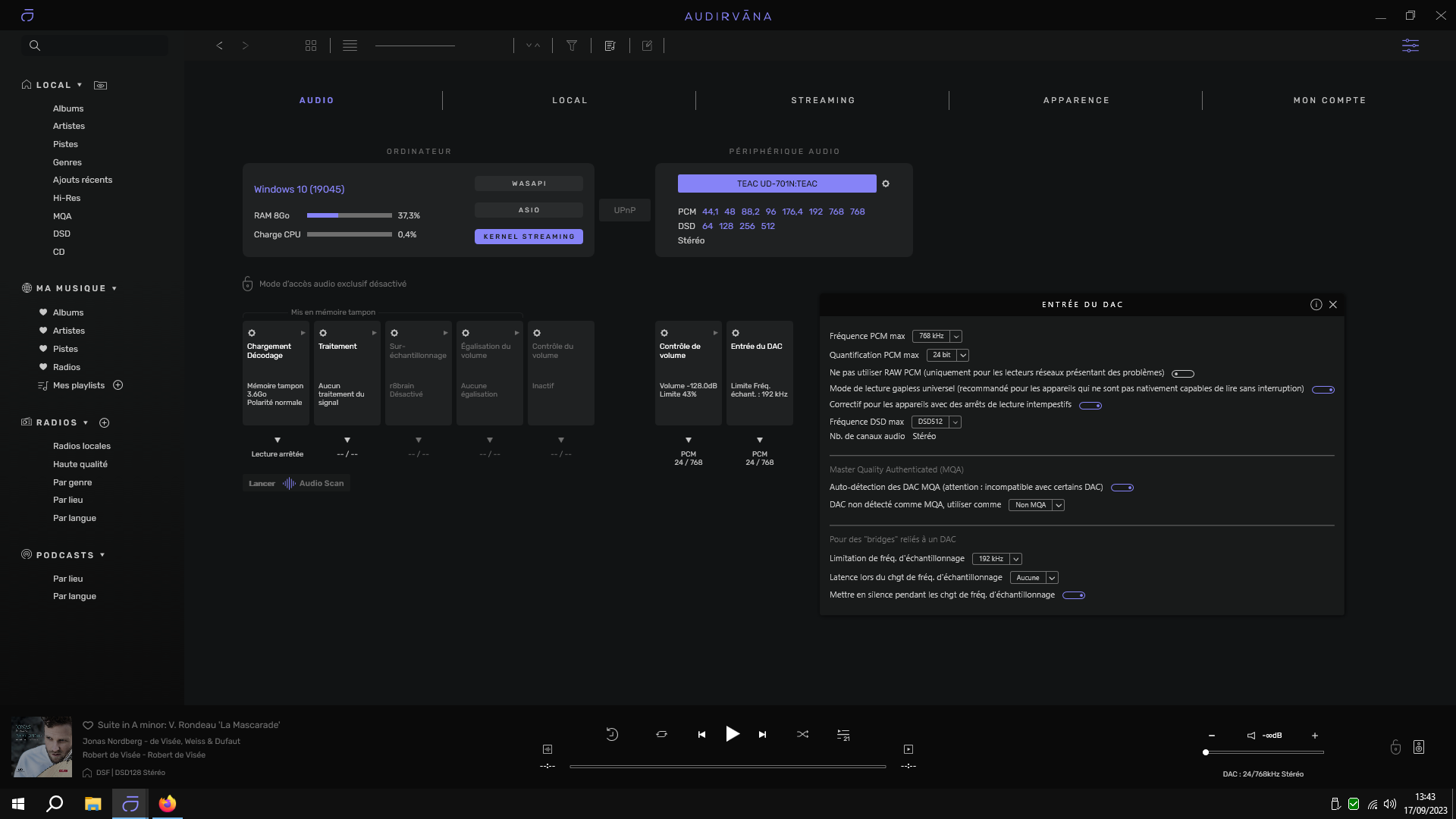

Here you are my configuration.
Maybe try backing down to dsd128 for a test, dsd512 could be a bit ambitious.
I try with upsampling DSD 64. It’s the same : no sound.

Hi @Jacob , you are not seeing anything from his screenshots? Does volume play into dsd like it does on MQA?

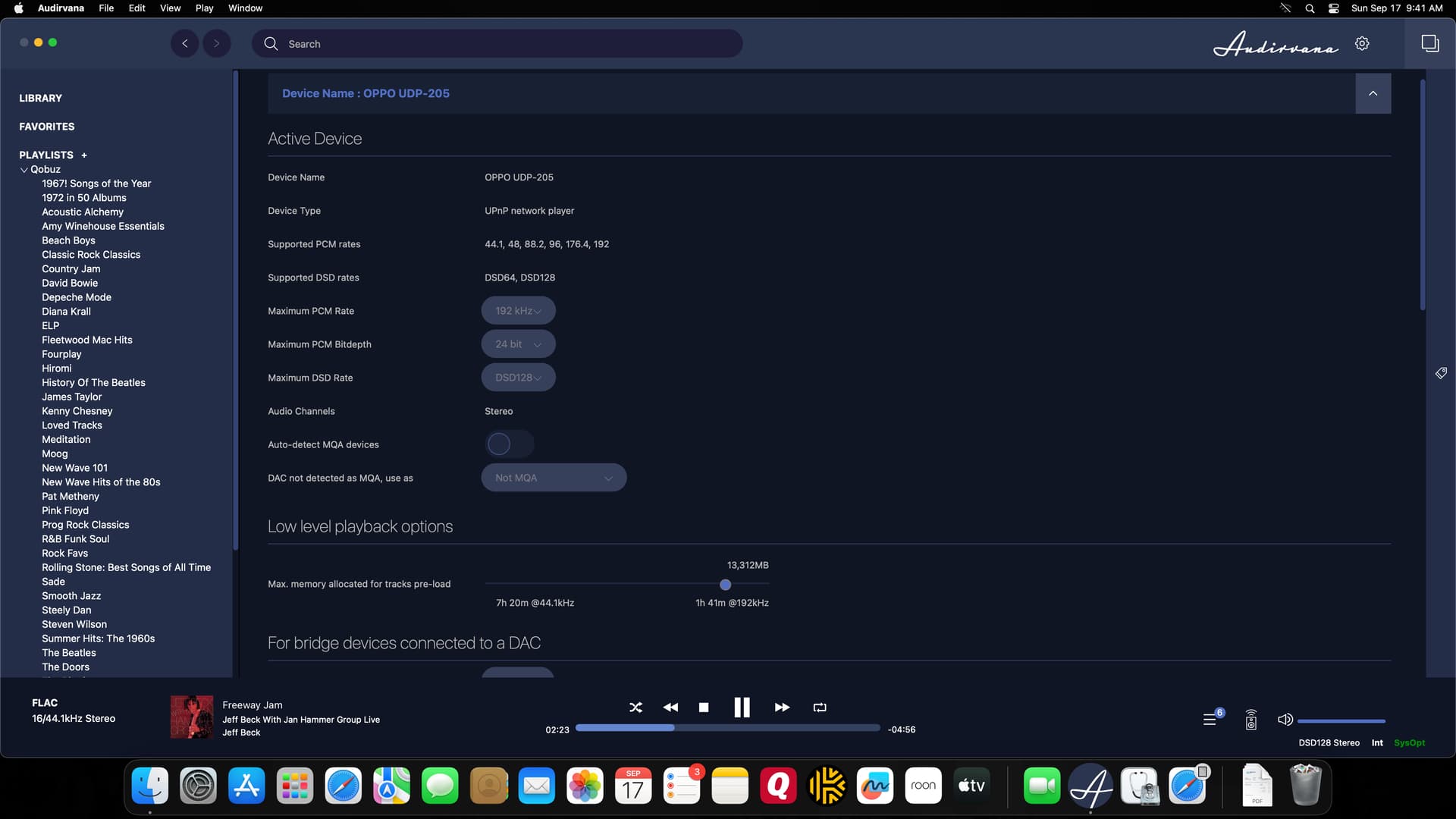

@OffRode Did you have the same problem with the Oppo? Playback with PCM but not DSD?

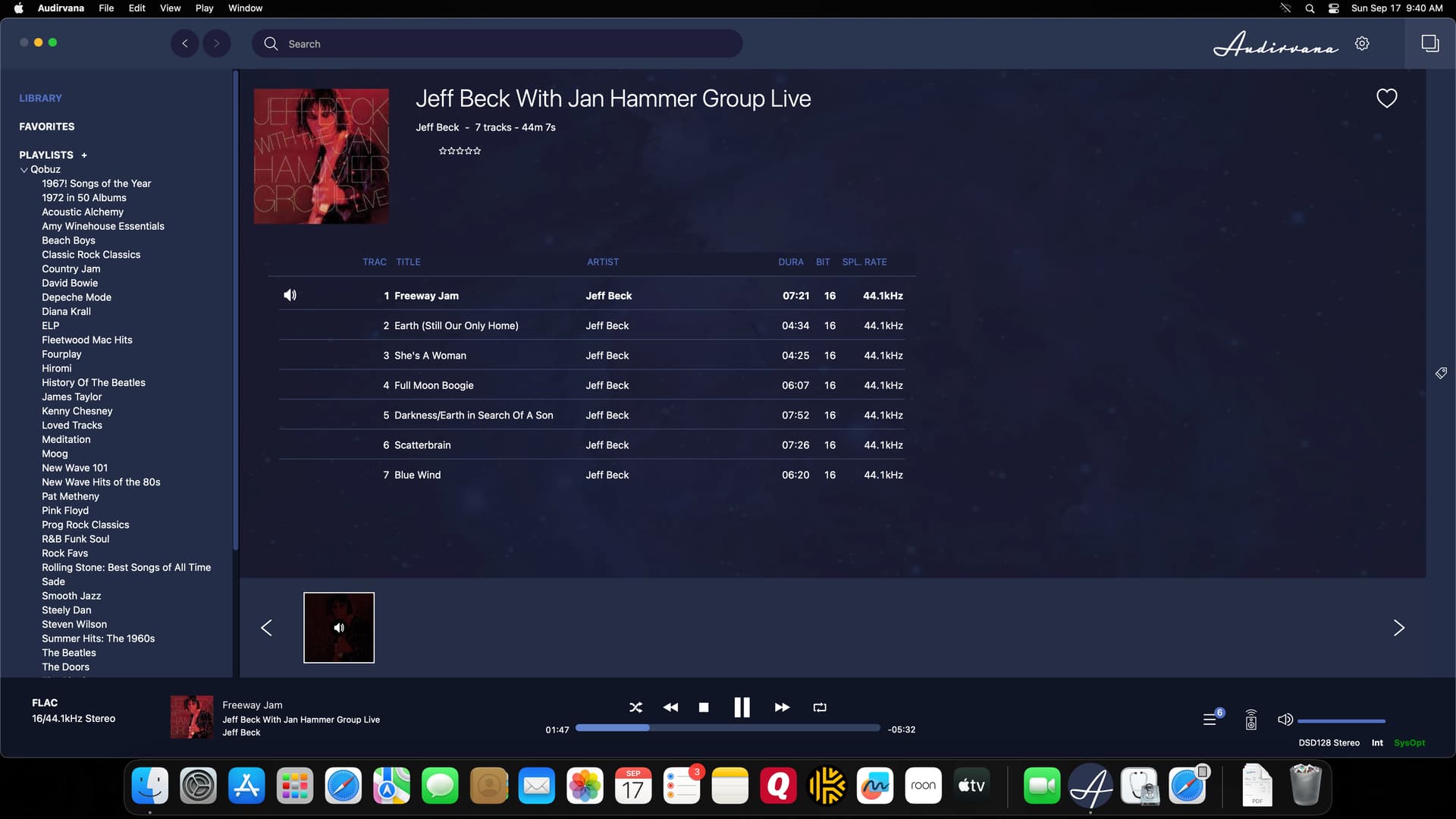

No I don’t, Remember I’m on 3.5. Here’s my setting on ethernet, my Zen Stream also does DSD128 no problem. My only issue is 24/192 Long tracks crapping out.
I always run all volumes a100% that’s why I wondered about @jcmpgp screenshots
Edit: seems like 3.5 doesn’t allow volume control via Ethernet UPNP? Never really noticed due to the fact I run 100%
I assume that is the volume control of the Teac. And that you should be able to operate it without the DSD no longer working. But you can always try.

Good thinking, I have the Oppo settings to 100% fixed, maybe we need @jcmpgp to look at the Teac settings a bit. I have headphones volume variable but line out is fixed.
My assumption comes from the fact that the volume control after the DSP bus controls the analog volume control of my Hegel. I don’t know if that is also the case with the Teac.
Just tested and DSD played fine with variable volume, I was grabbing at straws.
