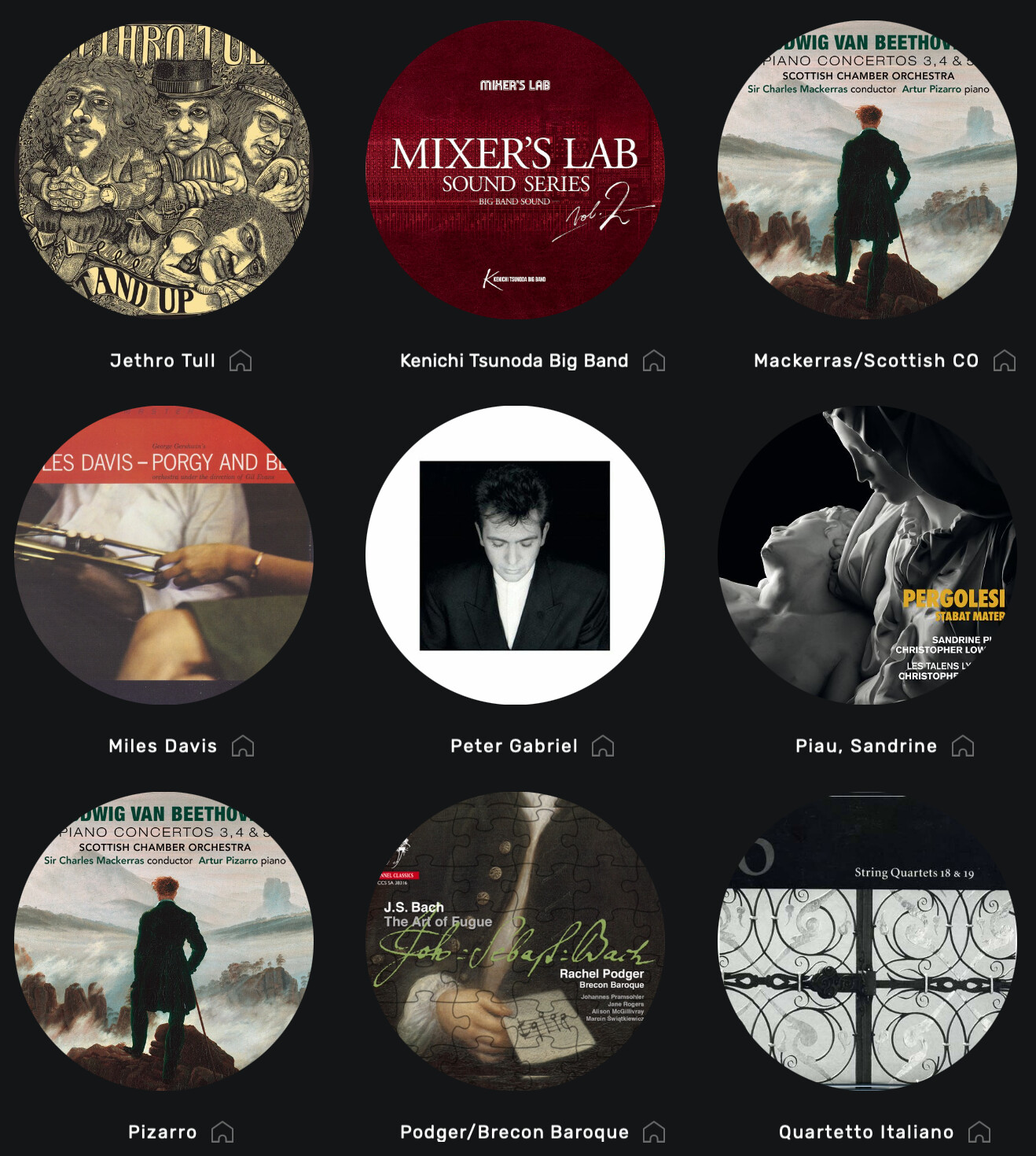

AS does not know to sort metadata
00002096 ALBUMARTIST
|…ALBUMARTIST=Piza|
|rro |
00002119 ALBUMARTIST
|"…ALBUMARTIST= Mac|
|kerras/Scottish CO |
You need to look at the lines with ALBUMARTIST. As you can see you have tow album artist line, then Audirvana will them as two separate artist.
OK, now I understood. I’ll check the Raw metadata of the album “Beethoven: Late Choral & Gershwin [SACD]”
The fact that AS displays two different “Album Artists” in “Artist view” for the collaborative album of “Menuhin and Kempff” is a problem. They are both “Album Artists” in this collaboration, but they should be displayed together.
Buy why AS did not create the same thing for “Pizarro” and “Mackeras”, though both are “Album Artist” in the Raw data?
In fact I can see them in the Artist view of your database:
You are right. I missed it.

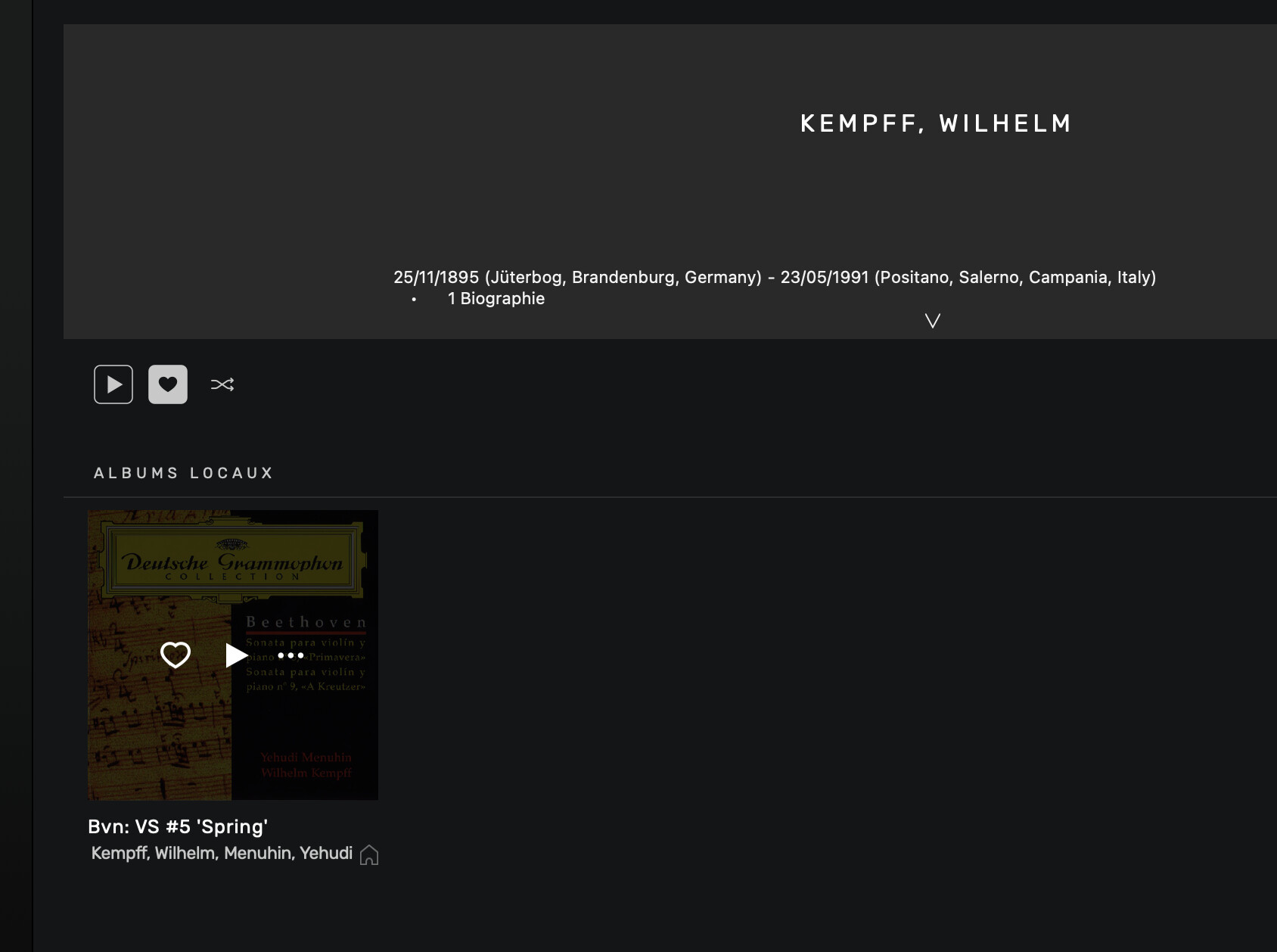

581149417: 54 52 43 4b 00 00 00 07 00 00 00 31 33 2f 31 33 00 |TRCK…13/13. |

Indeed. In this album, there is a single Album Artist, and there are two Artists.
I sent you its screenshot yesterday.
The problem is the separation between “Albums Artists” in collaborative albums.

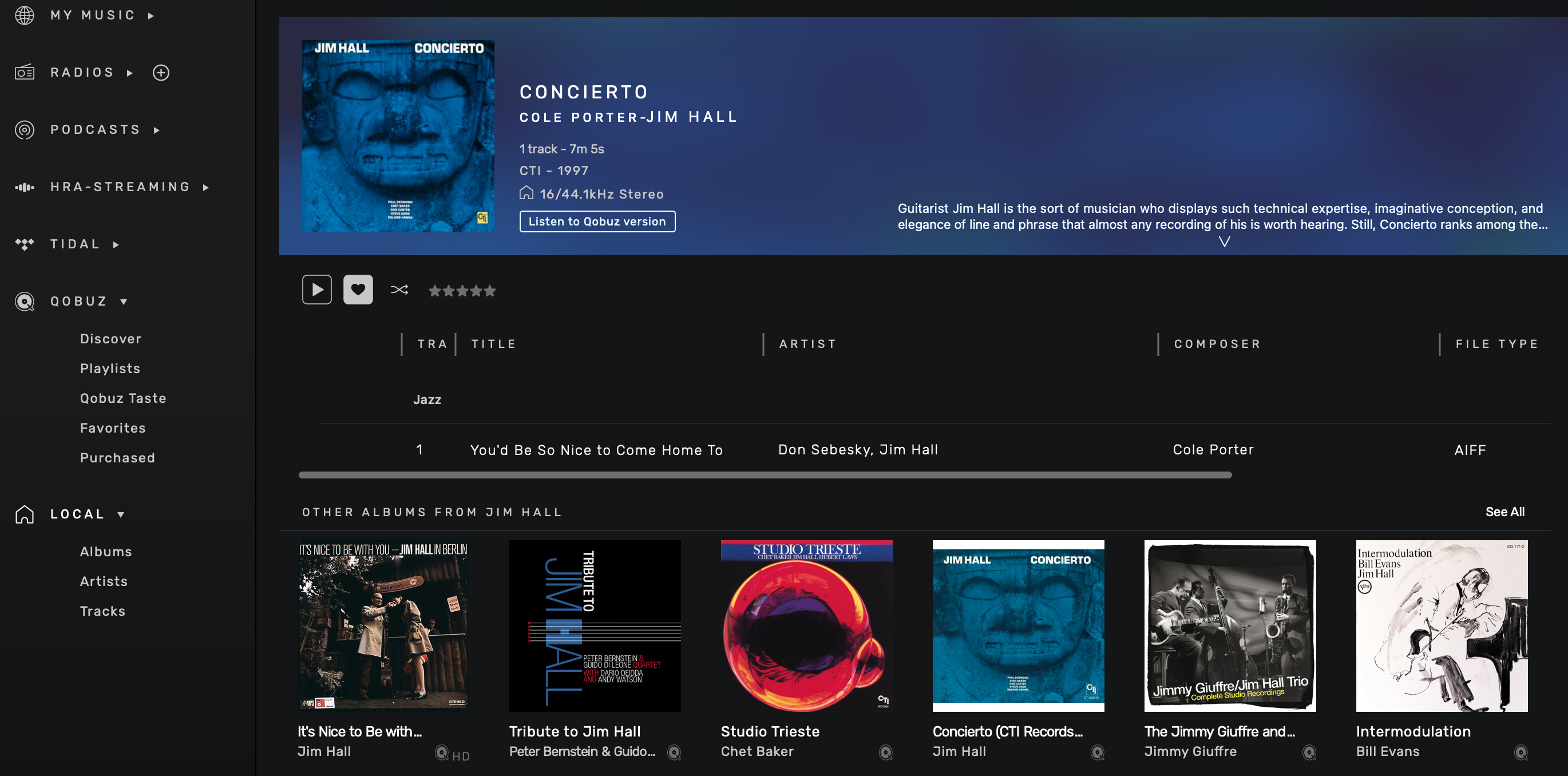

This is strange, when I open the album linked to the file you send I can see the Qobuz recommendations and bio but not on your screenshot
I would like to see your sorting criteria in Studio while you see your albums, can you send it here?
