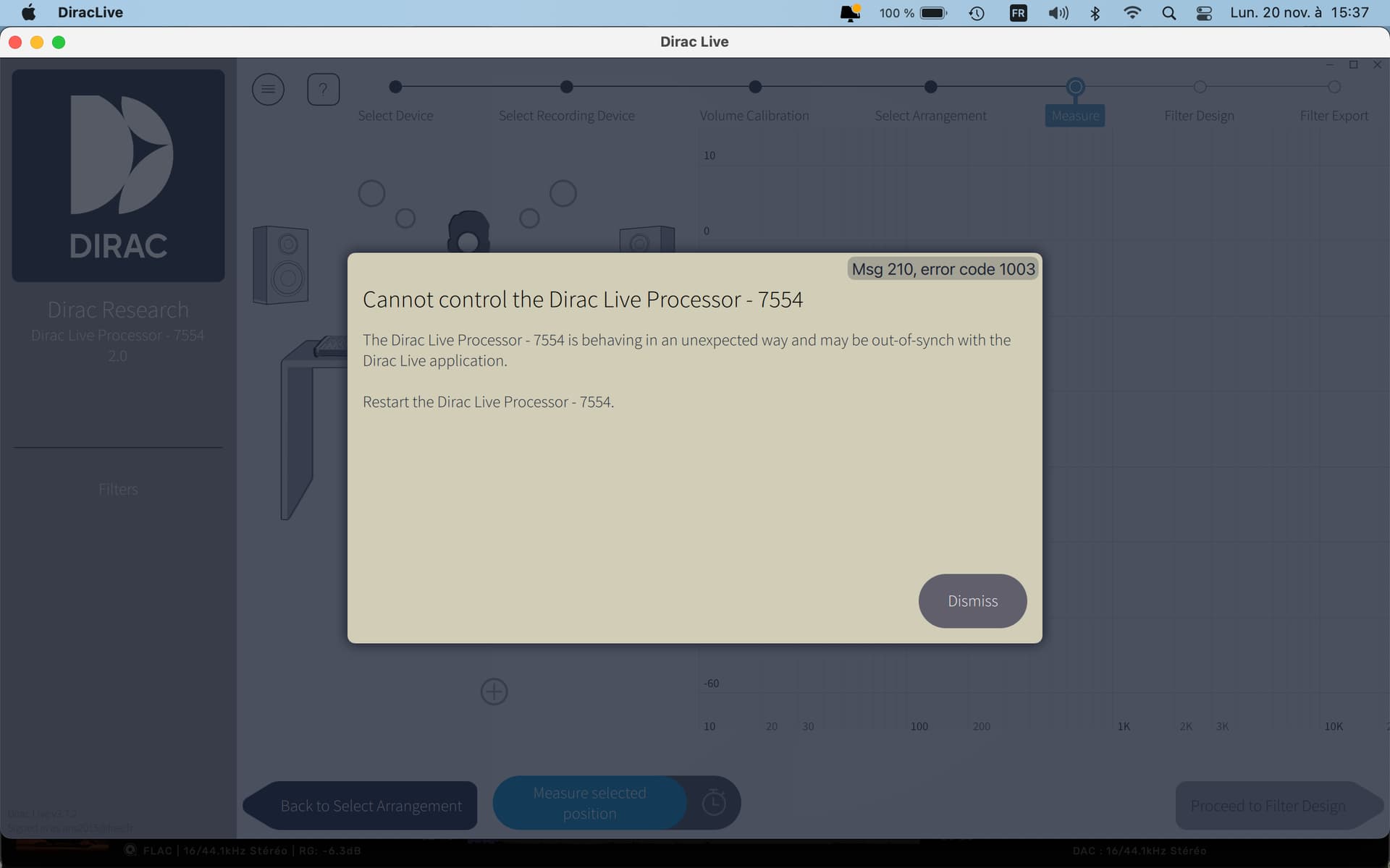

My initial question was : " Is it possible to calibrate a room with Dirac plugin on a Mac with Audirvana Studio using UPnP ?" I mean can I use the configuration button for the “Dirac Research Direct Live Processor” plugin to calibrate a room using UPnP ?
I tried to configure with and without “realtime control” : Dirac Live that is fired within this configuration sends an error message when I perform the first measurement (see attached image)
So this question was specifically focused on Dirac calibration within AS.

I don’t think this is possible. In UPnP, audirvana already renders before playing the file. While for a measurement Dirac needs to have real-time control over the plugin.
Thanks @Jacob , that could explain.
I would like to have a confirmation from @Antoine to be definitely sure it is not possible to calibrate with UPnP and then I will try to find a way to use USB .
