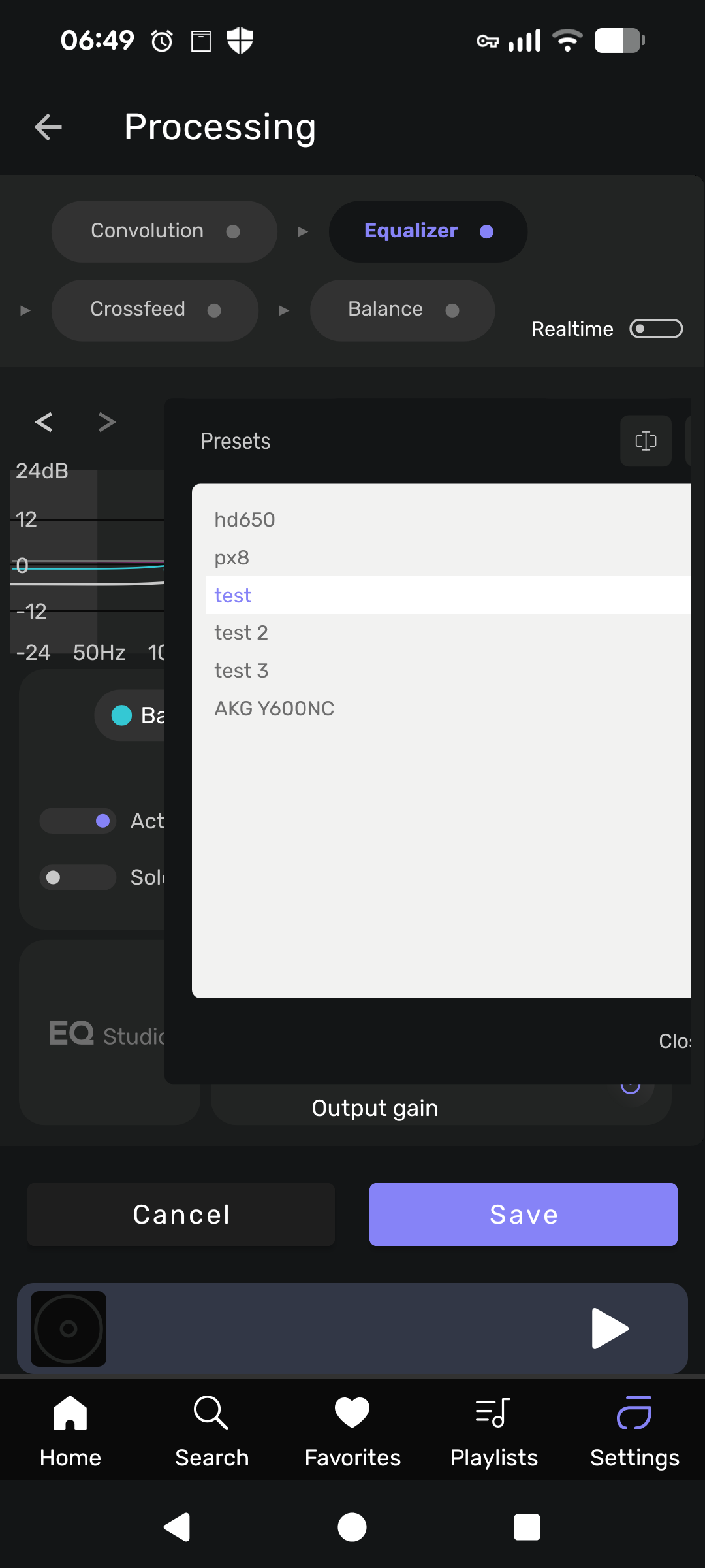

In the current version of the Android Remote it is not possible to manage the presets in the EQ because the pop up isn’t completely visible. So if I want to delete one I can’t.
Hi @Amarok1969 , it’s a known issue for quite some time and we will look at it very soon.

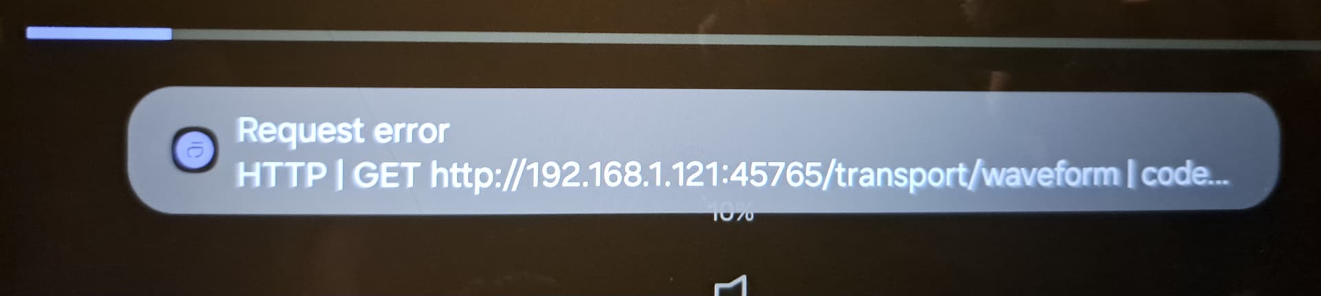

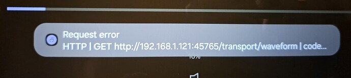

Unfortunately, the issue with the MUTE icon not working still exists and I’m getting a lot of these:
Can you send us a copy of the "Debug Info“ when you have this behavior? You can get it in Audirvana Settings>My account.

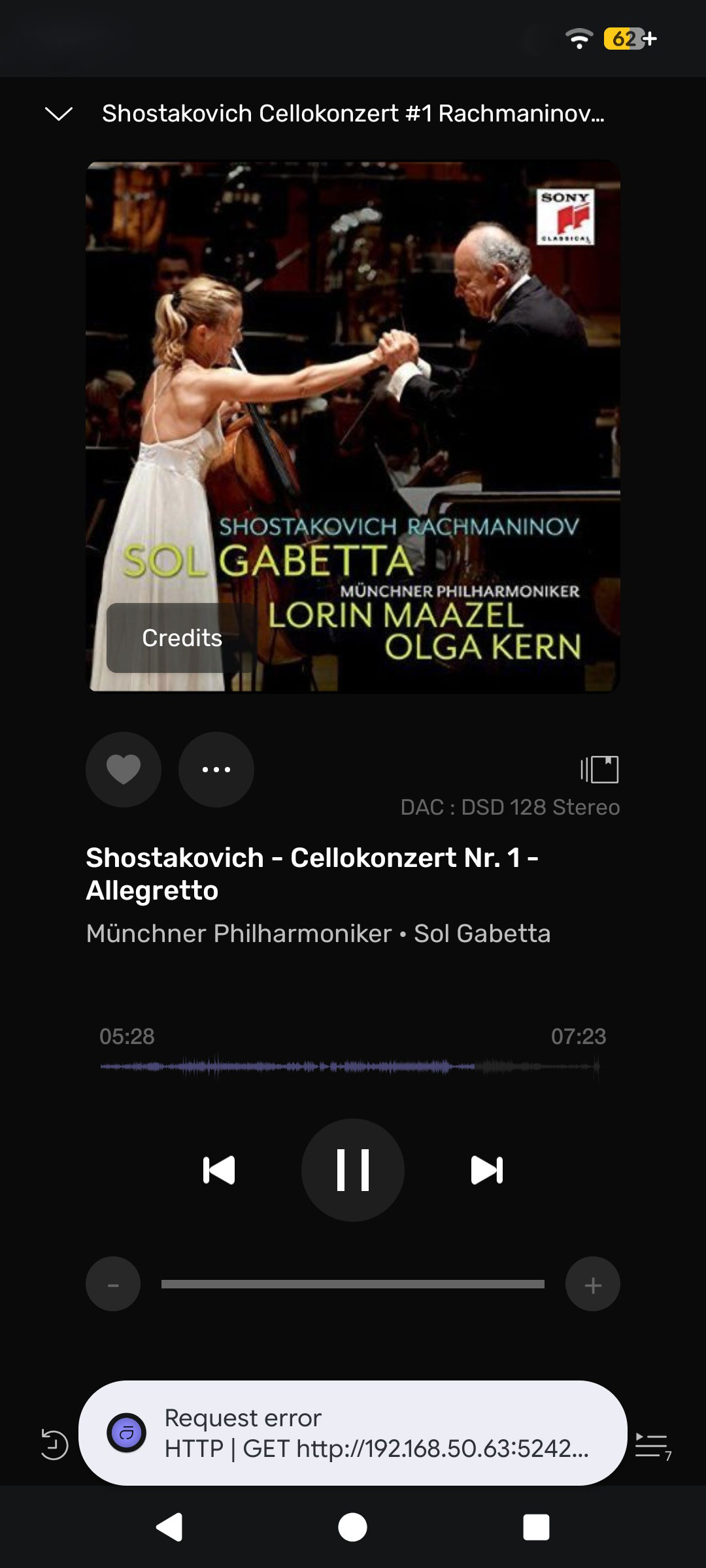

Since the last remote update i have this messages lot. Everything works further okay.
Synology Nas 2.9.17. Android phone version 17. Tablet android version 14.
Perhaps a relevant detail: my nas has two networkcards. One is connect directly connected to the streamer, so in a different subnet.
Can you go under the settings in the Appearance section and check if this is activated?
Yes, it is activated.
Can you deactivate it, then play a track, and reactivate it again? Do you still get thie error only when the setting is activated?
@Antoine With a deactivated switch i recieve no messages. Reactivated the message returns.
I could reproduce this. Sorry about this issue.

Mute still not working. Error message still shows up when waveform turned on.
