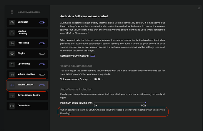

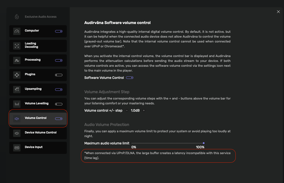

Okay… I see the note about applying Software Volume control when UPnP is enabled… the latency involved creates problems in the handshake…
